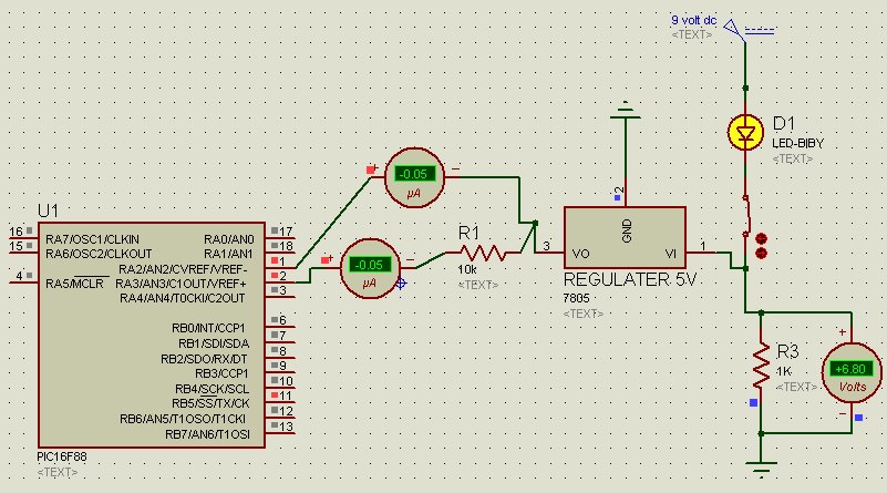

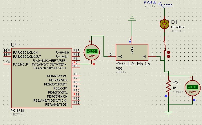

I have three question about pic microcontroller :
1- When I the connect the output voltage of regulater 5V to pic , the voltage drop to
half as shown in the lower, why?
2- is conduction in above right?

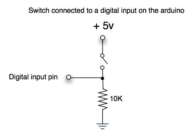

nor I must connect the output of regulater 5 volt (7805) to pin digital input
on pic 16F88 and to ( resistor and ground ) as shown in the lower ?

1) and 2) A voltmeter should be connected across (i.e. in parallel with) the voltage source to be measured. Your meter is in series between the 7805 output and the micro pin.
2) In the second pic the 5V connection is fine, but your switch will need to be debounced (in software, or by using additional components).
3) Read the datasheet for the micro and follow its guidance about capacitors.
Edit: The input voltage to a 7805 needs to be > 7V for it to regulate properly. Your LED is dropping the voltage too much. Run the 9V directly to the 7805 input.
