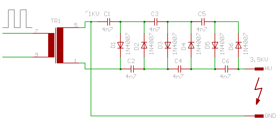

HV can also be generated by using a cascade as shown in the attachment.
Each stage of the cascade will add to the original voltage.
Shown is a three stage cascade.

That's a voltage multiplier arrangement. You cannot expect much current from that sort of configuration without some sort of pass transistor.

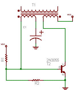

What you want to do is build an oscillator and use a large ferrite core as a transformer. Here is a simple single stage converter I have poster a few times. The transistor is a 2N3055 and the core is an Amidon ferrite core about 1 inch outer diameter using number 43 mix. The turns ratio is around 12 to 800 turns and delivers about 2000 volts.
There are many arrangements and configurations. For really high power most use IGBTs. This is just something to help you understand the concept which is by building an oscillator you are effectively transforming the DC voltage into AC which can be converted to a different voltage level through the use of a transformer.
