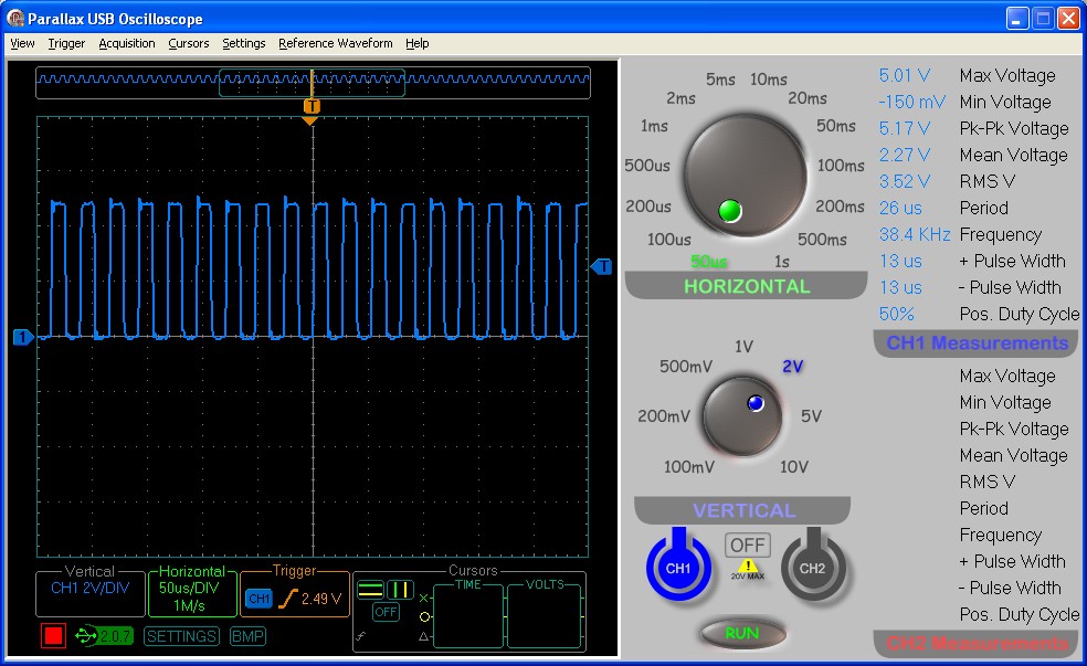

Again at 4mhz on a 628A. But looked at in the scope and Boost C.
:p
Here are the numbers for 18F1320 at 8 mhz
These are the goodies to set up for 38khz
// 38 khz
#define CCP1Period    12
#define    CCP1DutyCy    25

Here is the wave form:
https://www.electro-tech-online.com/attachments/capture4-7-2008-8-22-38-pm-jpg.18506/
Actually much harder
It is actually much harder to get the software loop de loop correct. I have done it both ways as you saw. I would be willing to bet that my count of nops would be different on a different C compiler.
Whereas the hardware PWM will be consistent. If you notice that the off section has fewer nops because of the time doing the while calculations.
For beginner teaching, (which I understand is what you are doing), the loops may be easier to explain, but very hard to keep straight.
You really cannot use delay_us() calls because of the overhead of the call and expect easy results.
Of course, I cheated. I stuck the Parallax scope on the thing and made it right. If you call that cheating. Nearly 40 years of doing this stuff tells me you use whatever weapons you have at your disposal.
:D
