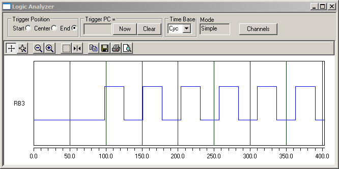

Krumlink has the detector working using the PIC generated output. Krumlink had the hardware and I used to simulator to kludge up the code for/with him.
We used processor cycles. Delay_10CTx(10) plus a few nop's to tune it. I used the simulator LA to get the timing close. Thinking is is + or - 4 cycles out of 220 or so.

I've posted this simple IR jammer code :) in another similar thread.
// 37.7KHz IR carrier
#include <p18f1320.h>
#pragma config WDT = OFF,OSC = INTIO2,LVP = OFF
void main(void) {
    OSCCON=0x72;
    ADCON1 = 0;
    TRISBbits.TRISB3 = 0;
    PR2 = 0b00110100 ;
    T2CON = 0b00000100 ;
    CCPR1L = 0b00011010 ;
    CCP1CON = 0b00011100 ;
    while(1) {
Put an IR LED on RB3 and it transmits a constant 37.7KHz carrier.
