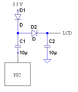

Have a small project with PIC 18F66J60 / Ethernet connection
It is powered by batteries and 3.3V/200mA generated by TPS60120
I need to add 5V LCD, so is it possible to generate 5V /30mA using PWM output and inductor?
For now I am using TPS60140, but would like to simplify whole thing.
I know I can use TL2775 and few external components as well
The goal is to cut the cost for small batch (~25 pcs)
Point me to the righ direction please.

this will be another option, but I need about 30mA, will it work? Can you point me to a working schematics please.
Like I said I have TPS60140 with 4 capacitors working, but trying to reduce cost.
What type of LCD you use that consume that much current? I've used one which draw only 3 mA that I can directly power from the PIC.

I think this is enough for a few mA. Try with a load resistor first.

The Max1680/1681 and ICL7660 can be configured as positive voltage doublers using only capacitors and diodes.
