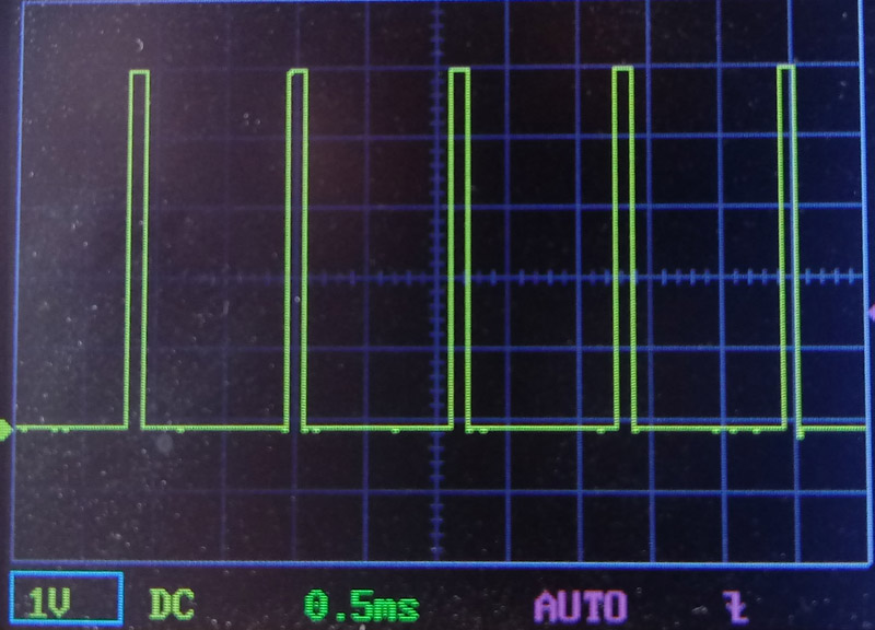

i need a PWM signal having a frquecny of 1 khz with a duty of 10% ..Does this guy can do this job?
As has been pointed out, yes, you can do that very easily...in fact, I just did it and it took about 15 minutes. I used a 202, but the only difference I see is that the 206 has a comparator...also, I only had a 202 on hand.

There are some caveats.
First is accuracy. I have used simple c code and am ignoring the time to jump and am depending upon the __delay_us function(). Of course, you can do this in asm and calculate instruction times and get better accuracy. Even so, assuming you are using the onboard osc, you will have some addition variability to address.
In addition to the accuracy, there is the issue of what else it is supposed to do. In the example above, it does not do anything else. You could fill those delays with stuff if you were very careful with timing (something simple like adding the capability to turn it on/off by another I/O).
