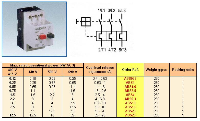

Use a thermal protection
something like the pic below
It's name, thermal protection, might be a bit misleading. It does not monitor the temperature of the load as some ppl think. The contacts inside the protection itself become a certain temperature (the more load, the hotter) and they release on a set current.
You should also place a normal short-circuit protection (...a Fuse) in series with the thermal protection.
Hi Exo,
Have these motor protectors a faster response time than circuit breakers?
I have a 15Amp circuit breaker currently installed but when I run a load from 1 phase with 20Amps it does not trip. (it will eventually i think)
The other problem is Vibration. As these thermal overloads are purely mechanical it is very likely for them to fail after some time.

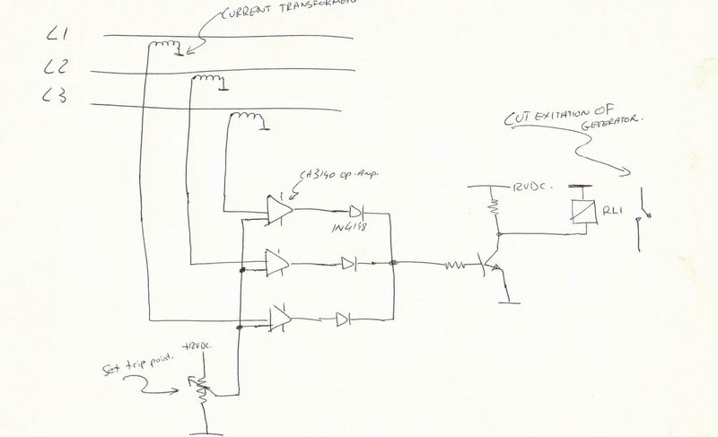

YEs it does have DC exitation. I have been scratching my head in the meantime and came up with a circuit idea. I will just have to get it neatly drawn (yeah right) on a paper. I will post it ASAP.

It's not the neatest drawing around...............
I'll do better next time!
This is the basic idea I had in mind. I still gotta ponder with a couple of resistr values. I got myself three CT today!!!! I'll keep you updated on my progress. A PIC will be added in due course for other functions. So what do you say about this circuit idea? Any other solutions are welcome.

Keep in mind that the current xfmr outputs will be AC voltages. You should bias one end of each xfmr up to VCC/2, and you can't drive a relay directly from the comparator output. You'll need a retriggable oneshot, a latch, or something similar to hold the relay on. You should look at LM339, which is a quad comparator. It has open collector outputs, so you can wire OR the outputs and use a single pullup resistor (the output will be active low). You might need input resistors and shunt diodes to the supply rails to protect the comparators from overvoltage.

OOOOpppps Ron H... what would I have done without you? You're right I nearly forgot that the xmfr was AC!! Thanks! I think in that case I'll just feed the op-amp through a 10nF cap and then bias it?
My intention is to use a CA3140 op-amp because of it's high input impedance(less load on the xmfr, therefore less error????) and secondly I can drive the input to within 2% of rail voltage. (thirdly 'cause in Namibia you don't get everything around the corner and I just happen to have a couple of them lying around somewhere LOL)
I would not drive the relay directly from the comparator but instead(for the time being before the PIC comes in) to rather use it as a trigger for a 555 "delay on" timer.
I've done a quick test on the xmfrs I got today and they all read differently when I run the sam load through them. Hmmmmmmm.......'will have to do some serious investigation............

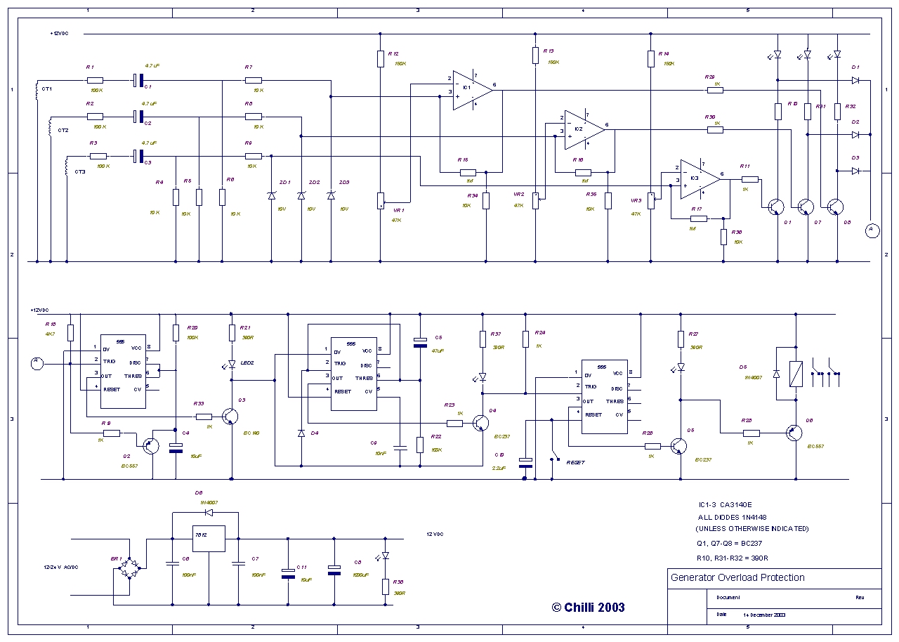

Hi Guys,
Managed to get a design on breadboard. I will post it shortly. It'll blow your mind!!!!!!
Chilli
Hi Guys,
Check out the circuit !
Works beautifully
Chilli
Good work, Chilli. I haven't looked at the entire circuit, but I have a couple of observations:
1. I see no need for the capacitors in series with your current transformers. They have no DC bias, so they can be connected directly.
2. As Russlk said, current transformers are meant to be terminated into a low impedance load. With no load, you get very high voltages, which is probably why you are having to attenuate the hell out of them. Remember, they are, as the name says, current transformers. The primary is, I assume, one turn (your mains wire). Let's say you have 30 amps in the primary, and your secondary has 1000 turns (just an example). This will yield 30ma in the secondary. If you have a 100 ohm load, you will get 3 volts out. Also note that the low frequency cutoff of the secondary is Fc=Rload/(2*pi*Lsec), where Lsec is the inductance of your current transformer and pi=3.1416. Notice that, as Rload goes up, the low frequency cutoff goes up (higher is worse). If each transformer is working below the cutoff frequency due to high Rload, The voltage you get out, while very high, will be dependent on the inductance of the individual transformer, which can vary considerably from unit to unit due to the fact that the core permeabilities vary considerably from unit to unit. Inductance is proportional to permeability. If you load the transformer enough to get into the flat portion of the bandwidth curve, the voltage out will be only a function of the number of turns, which is precisely controlled by the manufacturer, and all transformers will match very closely.
Did any of that make any sense?
I also noted what may be just a drawing error. In the upper right hand corner, the anode of D1 is connected to the wrong side of the resistor.

This is my basic idea of the circuit:
If you connect a scope to the output of the op-amps you will see a positive pulse whenever the voltage of the CT goes above Vref (Adj. by VR1 - VR3). This pulse I feed to a "Pulse stretcher" which is the first 555 Timer. Monostable with t=1.1*C*T (HA! See I knew one formula!!) which gives you round about 1.1 Seconds. You will see that it is re-triggerable.
The second 555 is configured as a "Delay ON" which gives you about 5sec
before finally triggering the third 555 which is configured as a "Flip Flop". Note it's "own" 0 V supply for the second timer.
The reason for the delay on is to compensate for Inductive (reactive) loads on the generator. The "Delay ON" timer" give you that extra time in the event of a momentary overload.
Thanks Ron for spotting the mistake! Youré 100% right. it is a mistake. :oops: You got a Eagle eyes huh?

P.S. Note the drawing mistake on D1. As RON ( 'ol eagle eye) has spotted, the anode should be connected to the other side of R10.
There is another mistake on the diagram. D1-D3 should be connected with their cathode to the collector of Q1, Q7, Q8.
'ol eagle eye didn't spot that one! :cry:
