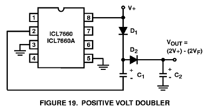

its giving me 7.6v for an input of 5v and 17.8v for 12v.
i want something aboout 12v from 5v {if possible}...
please help me out.
With a low current load, a 7660 charge pump should give an output voltage of about 8.6V from a 5V supply. Two in series should give an output voltage of about 17.2V with even less output current.

i m getting 7.6 v without connecting any load.....
and how do i connect two in series?
i mean can u be a little more specific how to connect two in series,parllel is fine but how in series??

The +7.6V output of the 1st one is the positive supply for the 2nd one.
Didn't you use at least 10uF caps?
Look, you don't need a cap between pins 2 and 4 like I showed before:

i ve one more question.... will it drive the gates of a mosfet {the upper one in a h bridge ckt.} or will it show loading effects???
Mosfets have a high capacitance from gate to source. To charge the capacitance quickly a high momentary current is needed. The output capacitor of a charge-pump voltage multiplier shoud be able to supply the momentary current and the long pause between Mosfets switching ensures a low average current.
