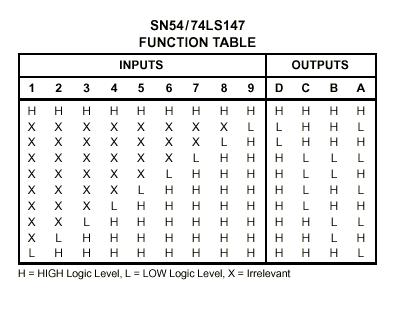

Hi Snowman,
Thank you for the links about form factor.
Its not a term i am familiar with.
The input pattern on a priority encoder gives a sort of 'ramp'
or 'slope' similar to the way you describe the light falling
on the array of sensors.
The table attached shows nine inputs, position ten or zero is
when all inputs are high.
The inputs are held high by pull-up resistors,
and active low takes them down.
The interesting thing is that the inputs are 'prioritised'
thats what the 'X' is for, the inputs of lower priority are
ignored.
If you aren't used to looking at these tables,
then just look at the middle row,
the row where 5 is marked as a low.
It gives the binary output for 5 thats fine.
What you can also see is that inputs 1,2,3 & 4 can also be low.
Cos they're marked with 'X's
Thats what i mean about the similarity to the row of sensors
you described, with light falling on a portion of them.
I was looking into an arrangement using this kind of thing.
I'm still thinking about this,
Would it be a problem to have two rows of sensors
instead of one ?
that might make circuitry easier ...
John :)

Hey John,
I'm not really sure what you're referring to with the sensors. All the sensors are independent units, there is a restriction on their physical arrangement but not on the underlying wiring between the sensors - that's what I was referring to.
For example, here's a 3x3 wiring configuration of the sensors, each "O" represents either a TTL level 1 or 0 that's coming from the sensor, and vertical/horizontal lines in between the sensors are shared data buses.
Let "(*)" represent schmitt tristate bus driver:
Shift register
O-O-O-->(*)->]
O-O-O-->(*)->] shift register
O-O-O-->(*)->]
What I meant in my previous post was that I would enable each buffer on the driver in turn using a decoder. I would this for each row and col in such a way that I iterate through them all (the input from the sensor would already be automatically cleaned by the Schmitt trigger circuit). If I feed these lines to the parallel load pins of a shift register and provide a seperate shared-clock for them, then AND their respective serial output pins, I believe I will get a "clock" signal for the chained 7490s controlling my displays.
I was confused by the suggestion of a priority encoder in this case, not sure how it would fit into such a design. Please let me know how you meant I should use them :)
Thanks again,
Avital

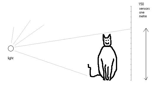

Hi Snowman,
Maybe i have mis-understood completely.
When you said they are spread over 1 metre,
i thought you meant all in one long line.
When you said the number of darkened sensors,
i was thinking of an obstruction, maybe a cat.
Maybe you meant darkened sensors here and there ...
Maybe they aren't all in a line ...
Do you mean something like this shown below,
or do you mean something else ?
please clarify ....

Hey John,
The sensors are not in one row over 1 meter as you drew, but simply packed in some configuration over a surface that has length of 1m (unknown width at the moment) - that is, a 2D surface, not simply a line. It's important to note there is *no* priority to any of the sensors - information from any one sensor is equally important. Regardless of how they're packed, the problem is the logic required to process input from so many sensors in a reasonable # of ttl chips - this is my problem.
Regards,
Avital

A priority encoder wouldn't really help, since all of the inputs have equal weights. The counter schemes mentioned so far are equivalent to performing unweighted addition on 150 inputs, one bit at a time. There's nothing wrong with the concept, since a reasonably fast counter clock will output results that fit your definition of real-time.

Yes, i didn't see quite what you wanted,
The priority thing is clearly not what is needed.
I think that laroche73's suggestion of using those
