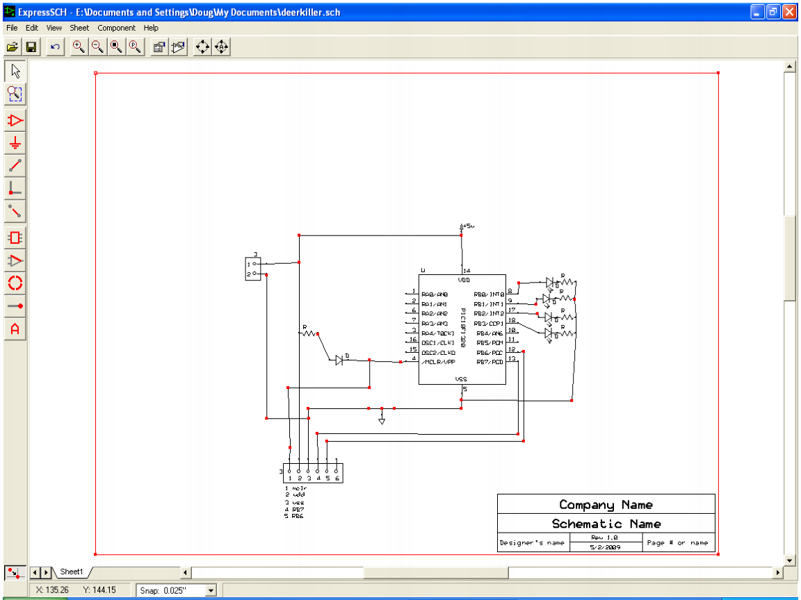

here is a schematic I use
I have a test board wired to check ports. The Junebug is charlieplexed so its not real easy to just turn on one LED.
I want more control over the ports thus this test board.
just connect the LEDs to desired port pins etc.
very basic but it works.
I wanted to test a PWM project I am working on (LED candle flickering) using 3 LEDs.
on my test board I soldered a 5 pin header so I can connect the programming cable from the Junebug to my test board w/o pulling the PIC every time I want to change the code.

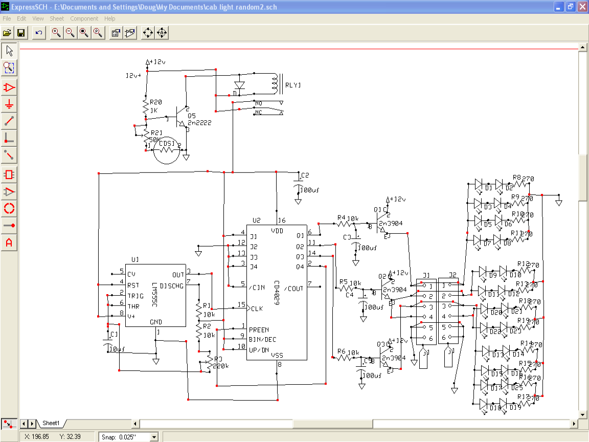

Hi MrDeb how are you?
I made a LED candle flickering with a 12f508 and some resistors to make a sine wave
You posted a link way back to how to do it that way so I tried it with some yellow leds
It worked better then you would think

No that chip don't have adc . You use 5 resistors as a voltage divider. By changing which one is on you can very the voltage. here is the circuit
that can't be right??
looking at schematic, the transistor turns on and all three leds turn on.
by varying the base voltage the transistor conducts less thus dimming the leds??
isn't this hard on the transistor (not saturated??)
maybe I is missing something??
It works I ran it for about a hour and my little 2n3604 don't get hot your just talking about 60 mA wouldn't be any thing different then it osculating
