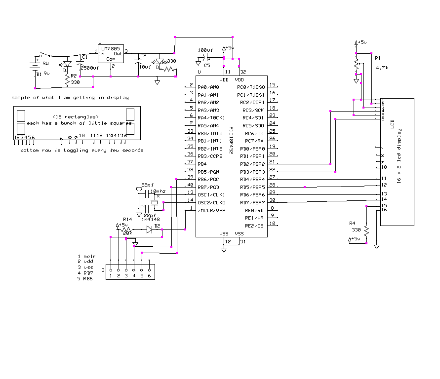

disconnected from junebug then attached battery
LCD shows several white long thin rectangles that change
must be doing somethig?
tried adjusting the pot
no black digits or ??
am I supposed to have a connection to the backlight terminals on the LCD?
also when using Junebug, I press F10 (compile n program I get a message that I need to reset the targer device. Am assuming this is just MCLR? Tried pressing my MCLR button and still get message.

**broken link removed** 15 & 16 pins are to be connected. Not sure why the schematic shows two 471ohm resistors in parallel when a single 330 ohm would do according to ohms law.
I lit up the backlight and now have a bunch of rectangles with little squares in each. Tried adjusting the 5k pot for contrast but to no avail. Looking at page 11 of the link it shows two resistors in series (47K,10K) with a 10K pot connected at the junction.
I just have a 5K pot connected as per the schematic Swordfish Tutorial - LCD
Need to change as I have 5v at pin 3 of the LCD regardless of pot setting.
I think its working though as the display is toggling every few seconds.
schematic& code
maybe I am missing something?
I get 2-rows of 16 white retangles as pictured in schematic
Device = 18F4520
Clock = 20

seems like its not initialized at all
Also clock is 10mhz in schem and 20mhz in code
why does MCLR have diode?
If you see those squares i assume that the POWER is OK and CONTRAST is OK/CHANGE_ABLE
Ensure that the connections are ok and also adjust the contrast and see if you can get anything...

The schematic was migated from the air cannon schematic that pre-scaled the 10mhz to 20mhz. Am using a 10mhz crystal
Using pickit2 I erased the PIC but get an error that says starting address not blank 0x000000
using a junebug to program. checked communication. says ok
Wondering if maybe I need to disconnect the LCD while programming?
NOTE I have to jump U5V to +5V in order to power the lcd off the Junebug (suggested by Junebug provider at Blueroom Electronics.
I noticed that looking from the side I can see what looks like letters. Tried adjusting contrast but to no avail.
Going to try and disconnect the PIC from the LCD (switch the Vcc and Enable or just the Vcc?)

I double checked connection, etc.
I am thinking it has to do with having to jump the Vcc in order for Junebug to power off the USB?
So maybe having the LCD connected is causing a write failure or incomplete write?
Thinking about inserting a switch to turn the power off to just the LCD then program.
going to try that
I inserted a switch between 5vCC and Vcc on LCD and the backlight.
I have to insert jumper on Junebug and then Pickit2 reconizes the device
It programs the device. I see the rectangles changing but no actual numerials or letters, just rectangles. The Pic must be being programed but maybe not right or the LCD is defective?
Adjusting contrast does nothing.

Wondering if The orginal code used a 18F4520 but I am using a 18F452. Only thing I did was remove the 0 and change the 20mhz to 10mhz.
The 4520 is basically the same as a 452??
not sure but if you drop the speed then the delays need to be speed up...
a delay for 100mS at 20mhz is 500,000 cycles
AND
a delay for 100mS at 10mhz is 250,000 cycles
Got a solution maybe (suggested by Jon at **broken link removed**
I still have a voltage regulator in the circuit when trying to program the PIC and powering the PIC with the USB via the Junebug.
Can I just attach the battery to the circuit as well as the Junebug at the same time?
Well it is apparently getting programed but the contrast does not do anything.
Getting 2 "0"s and a changing rectangle.
Not getting any voltage erros or any other errors. Going to proceed and get an LED to flash. Got to start somewhere.
