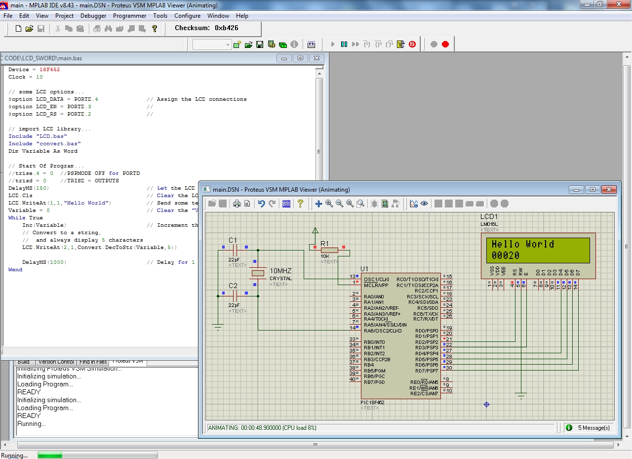

I doubt thats the issue tho... is RW for LCD tied to GND?
You must be having a HARDWARE issue...
You're also missing the mandatory 0.1uF decoupling caps on the VDD / VSS pins. Check out the Unicorn schematic as it works with 2x16 LCDs fine.
I have all the caps in place.
After fiddeling with Pickit2 I ffind I must use the "autoinport hex and write" box as just selecting write does not seem to work.
I got the dang thing working after fumbling around with Pickit2 and Swordfish.
