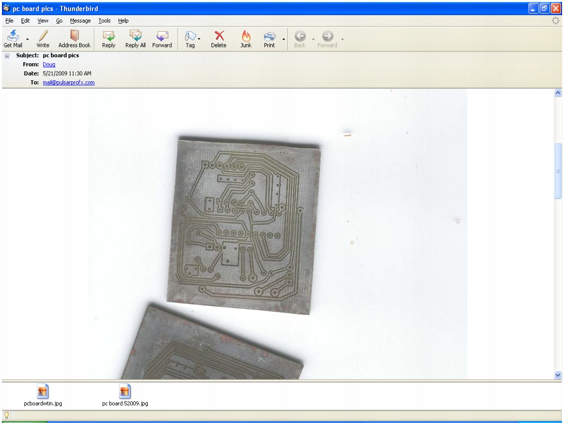

my results using PULSAR
I purchased the Laminator
set the printer to print density 5
warm the laminator for 1/2 an hour before using
use the 5mm setting on the laminator
CLEAN your board with dish soap and a Scotchbrite pad or 600 wet/dry sandpaper
pass the board through about 6 times switching around each time
use the green TFF paper to fill any voids in the print
pass through several times until you can see your circuit traces when you lift up an edge.
remove ink w/ acetone
CLEAN your board with dish soap and a Scotchbrite pad or 600 wet/dry sandpaper again
coat with liquid tin
all my traces are .020 except the one between the ic pins =..010
I filled all the unused ares so they wouldn't etch - not needed anyway.
I now need to drill my holes
Pulsar has a great product, just wish they had an iron on solder mask
screen shot of board w/ tin coat
here is a screen shot of one board with liquid tin coating.
used the PULSAR method described and etched using muratic acid and hydrogen peroxide

Does it really matter if the lines get slightly squished when heating on? I can do 8mil traces using regular photo paper and an iron. I haven't tried anything smaller than that. I guess if I needed them smaller I could give it a shot. The only reason I've ever needed 8mil was for this crazy IC with 0.4mm lead spacing.
Pulsar shows a .004 trace
now that's small!!!
I think the spreading of the image is not really true as the traces wouldn't be as smooth as they are.
