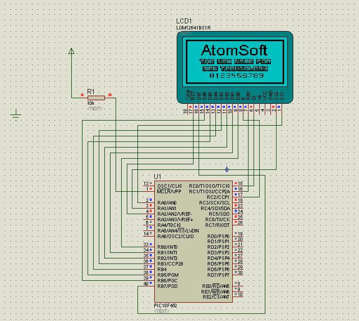

Thanks, looks like the previous code was BoostC instead of C18. Works like a charm, compiled fine and here is a snapshot running in Proteus. Excuse the ratsnest
