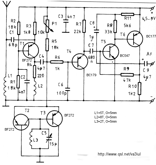

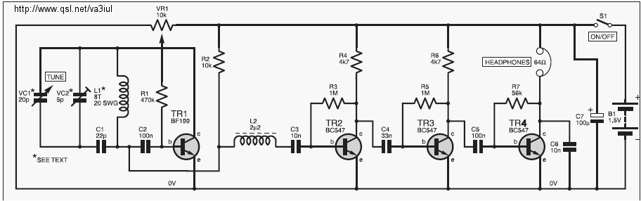

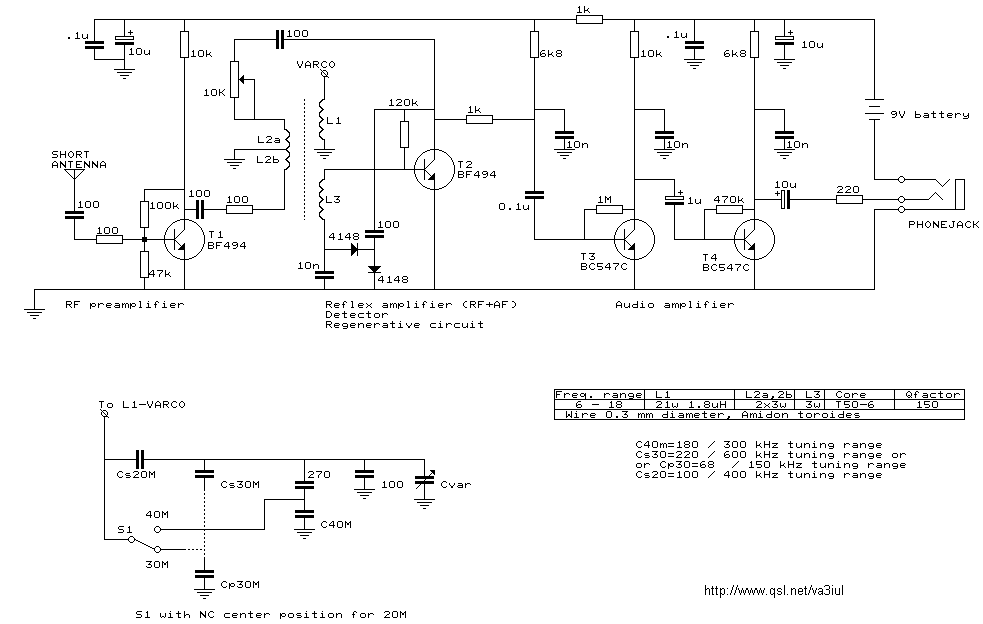

7.) this is the one i am haveing a little trouble with, a 2 way radio that is linked to the mics in the headsets that will send a signal back to a fixed location. i want the send to be activeated by a button, and i want the receive to be active as long as the power is on.
I was hoping that audioguru might be able to help with the transmiter and receiver. i was going to use his FM transmiter, but i was slightly unsure of whether or not the transmiter could be bumped to something like 20MHz.

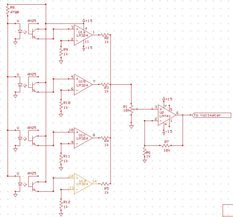

3.) An LED/voltmeter based speed indicator
