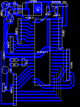

Maked by me
I make this for me.
Now the problem is hot to transfer it on my Copper coated sheet..
I make it in PCB123
Ayne said:
I make this for me.
I make it in PCB123
You should add a couple of 0.1uf caps as near as possible to the PICs power pins. The Inchworms powersupply can supply your board with up to 800ma.
Looks good to me, I'm knocking one up on a protoboard (tripad) I got from ebay, jsut while I wait for my PCB's to be made for 'the beast' board (which I spent far too long designing).
You could use stripboard if making PCB's is a hassle? The convenient thing about most micro's, especially PIC's is the pinout, most ports are in the correct order on the pins. Any 'odd' placements you can use jumpers, or wirewrap wire under the board to connect. Might not be easy for complicated designs, but for bringing I/O's to headers, providing power, a clock, and a programming header, it does the job. Plus you can easily design stripboard in a CAD software, like eagle, or PCB123, just remember which way the tracks go (left to right for your picture) and marks any track cuts.

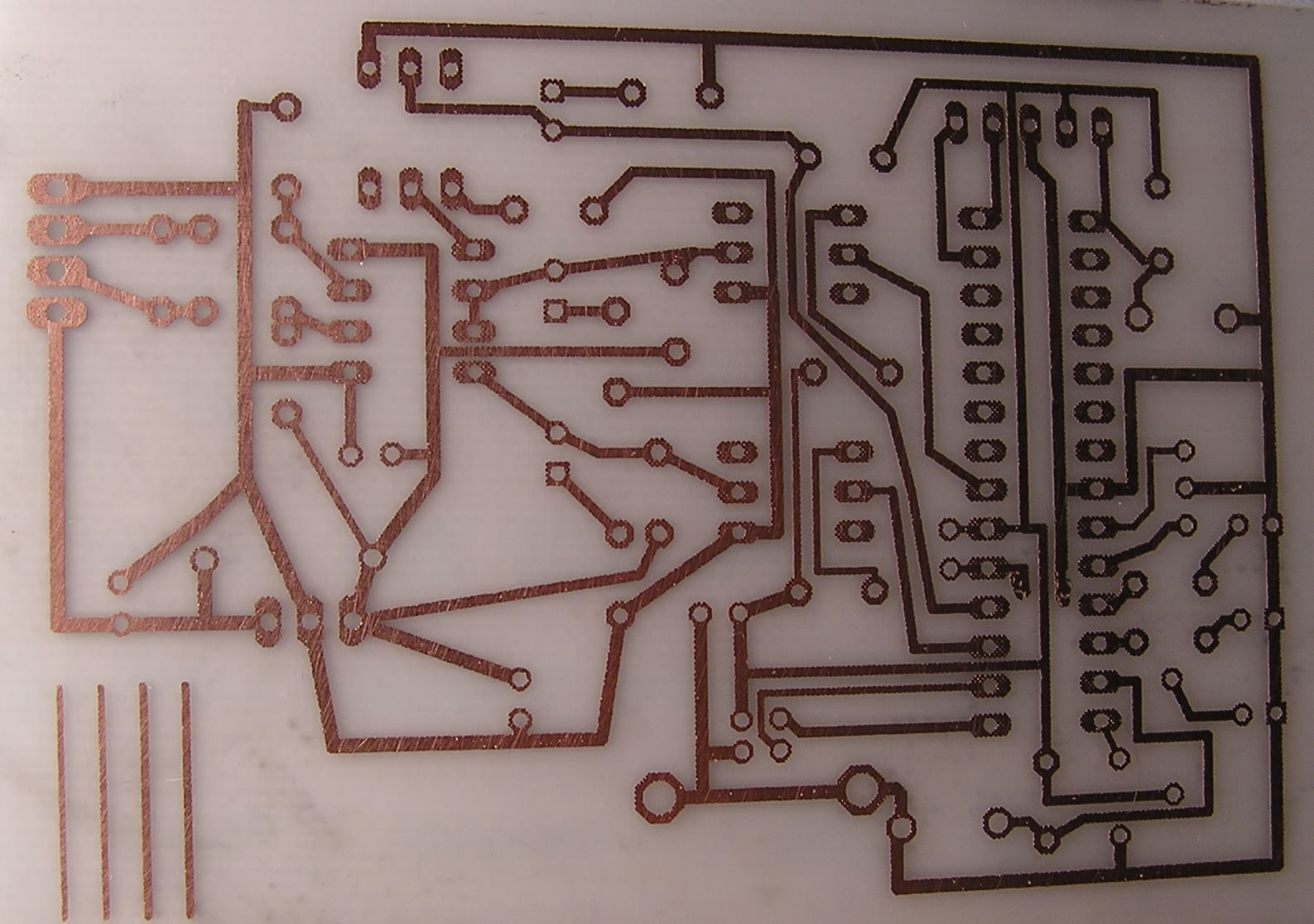

For free you can do this process DIY PCBs
I you want to skip some of the trial and error and use a more fool proof system you can **broken link removed** for less the 5 cents per square inch.
First board made using 15 minute method
