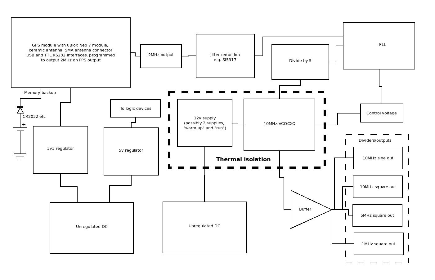

So I've been thinking what to do?
The NEO7 has a programmable output so it can output a frequency rather than 1pps. Needs a battery to not forget its setting if not powered for a couple of hours though.
Timepulse suffers from jitter, if programmed to a frequency it is much better when an integer fraction of 48MHz, eg 8MHz
So I believe I can use a PLL to improve the jitter, or one of these: https://ww1.microchip.com/downloads/en/DeviceDoc/JitterBlocker.pdf though I'm not sure it's appropriate in this case (if I can even obtain one!)
How hard is it to phase lock a 10MHz signal with an 8MHz one? Divide the 10MHz signal by 5 and the 8MHz signal by 4, is my first guess. PLL generates the control voltage for the oscillator. I don't know if programming the module to 8MHz and dividing externally by 4 is any better than just programming it to 2MHz. Still an integer fraction of 48.
I've also seen one where the 1pps is divided by 16. Confusing...
I was thinking also, instead of this, I could use a "fastest finger first" system. So the 1pps signal is used, and the 10MHz oscillator is also divided down to 1pps, and the difference in time between them is used to give the oscillator a gentle nudge in the right direction. It would need additional syncing so the pulses start off in the right place. Very slowly done, so the effect of GPS 1pps wander doesn't have the oscillator all over the place. Don't know how I'd do this but it's an attractive idea. Some kind of integration of the time between the two pulses?
The other way to do it is with a micro, AFAICT, it would need to measure the interval between each 1pps pulse and generate an output equal to the average pulse timing. This led me to thinking it wouldn't be a very stable average because the micro's own clock isn't truly stable, and THEN I thought, hang on, I've got a 10MHz OCXO on board, use that for the micro's clock instead, and I THINK that as it's frequency is adjusted this will affect the average in a negative feedback kind of way so it won't go racing off to the upper or lower limit. But I was driving when I did that thought experiment so that may be completely wrong.
With a micro on the board it is also possible for other things to be done. Haven't thought much about this, mainly just getting info from the GPS, status info, fluff and stuff.

Ok here's a block diagram of the PLL version. I think this would not be as good as the 1pps averaging version, but easier and quicker to make because there's no need to program a micro and deal with a dac. It would be usable more quickly after switch on too. Comments, anybody?

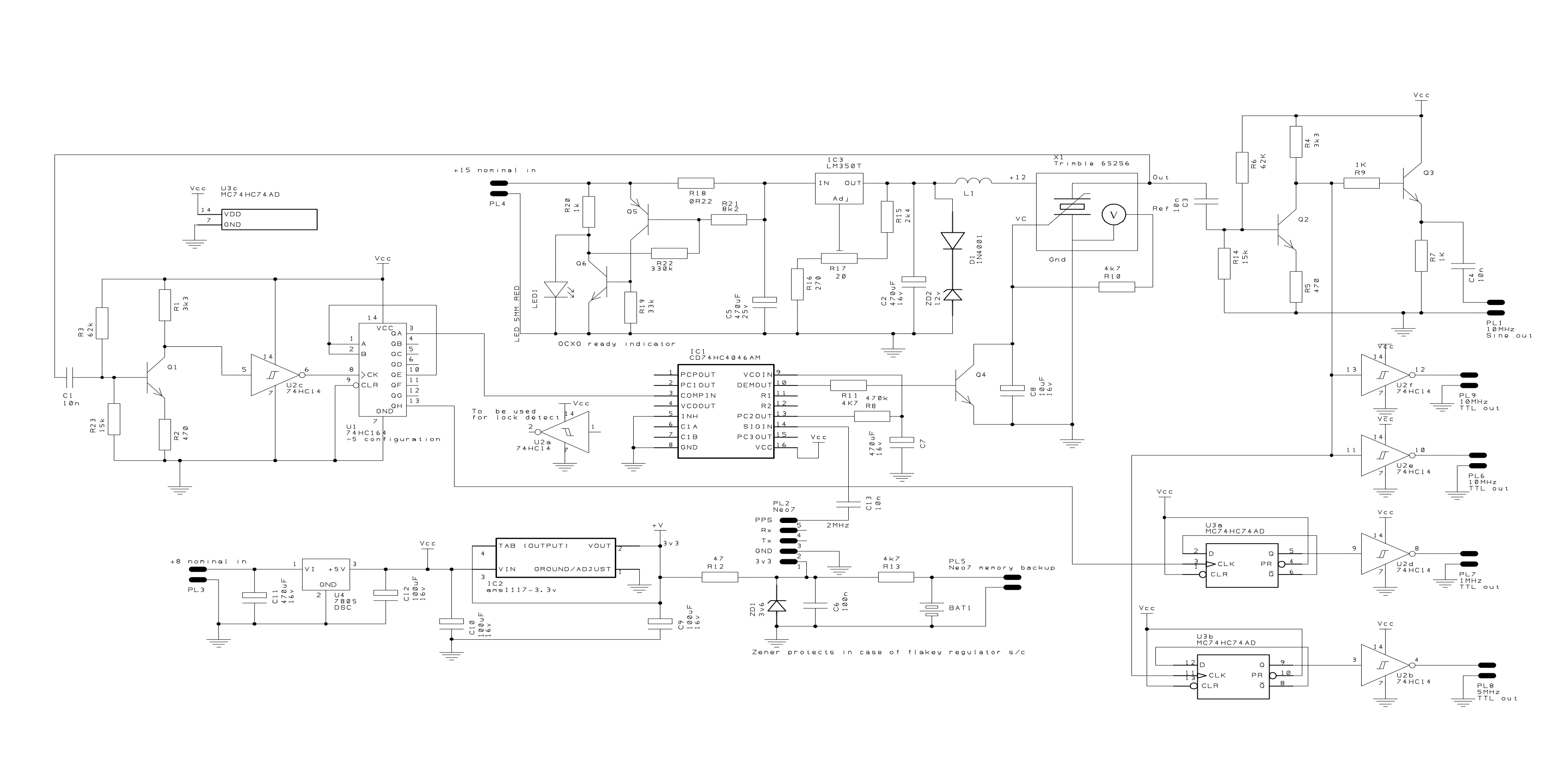

In my latest project I'm thinking of using a 'hc4046, however I need to be able to force phase comp 2 o/p to go high impedance regardless of its inputs, messing with the inputs is the only way I can think of doing it.
This is my first draft of the design. Quite a few of the component values are placeholders because I don't have much info about the OCXO, or just haven't got round to working them out yet.
I designed it after post #13 but have only just seen #14 - that app note is exactly what I've been needing (and failing) to find so I'll be making some changes no doubt. Thanks for that S/T. I'd already chosen 74HC4046 because CD4046 won't go to 2MHz. 7046 is expensive!

Looks Ok as a ball park, except Q4, that doesnt look right, you could just connect the chip direct to the ocxo, the demod out is a low impedance op amp output.
A couple of things to note, without any biasing the Pll will have to charge up the loop filter cap to 1/2 Vcc (assuming you want the osc control voltage to run at 1/2 Vcc) this will mean a long start up.
The other thing is the loop filter is only single pole, it'll work but will overshoot & ring for a few cycles after power up, maybe taking nearly an hour before a really good lock is made.
That said I'm not knocking your design its further on than my gpsdo was when I started to assemble it, chuck it together and see.

Yeah I realised about Q4 afterwards. It just seems a shame not to use the OCXO's reference voltage. I don't actually know what the control voltage range needs to be, or what the reference is, until I've got the oscillator - it's still on a boat somewhere. I'm hoping it's the same boat as the Neo7. If it's around the 5-6v mark it might be a good idea to use it as the PLL's supply voltage instead of Vcc. There's hardly any information about the OCXO so I'll just have to hook it up and take measurements.
Loop filter is still dark magic - I'm learning slowly. I just went for a really long time constant. I may yet switch to using the P3 comparator.
The osc control voltage will only be as stable as the loop filter, so I spose a reference isng going to be a whole load of use, unless you make some kind of circuit that generates a ratio, 0-5v in and 0-xtal osc reference out, but that will only be as good as the Pll's supply voltage anyways, so dont worry about it.
You could if you really want a clean voltage for the phase comparator o/p have a seperate reg for the 'hc4046, or maybe construct your own reg using the ovens reference.

I couldn't understand why there is a 22K and 1000u in series in his loop filter:
(edit - better copy uploaded)
It is loop damping, and I would suggest that you add it, in series with your C7.
Start with a resistor value 1/20 or 1/10 the value of the main loop resistor.
