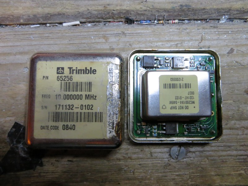

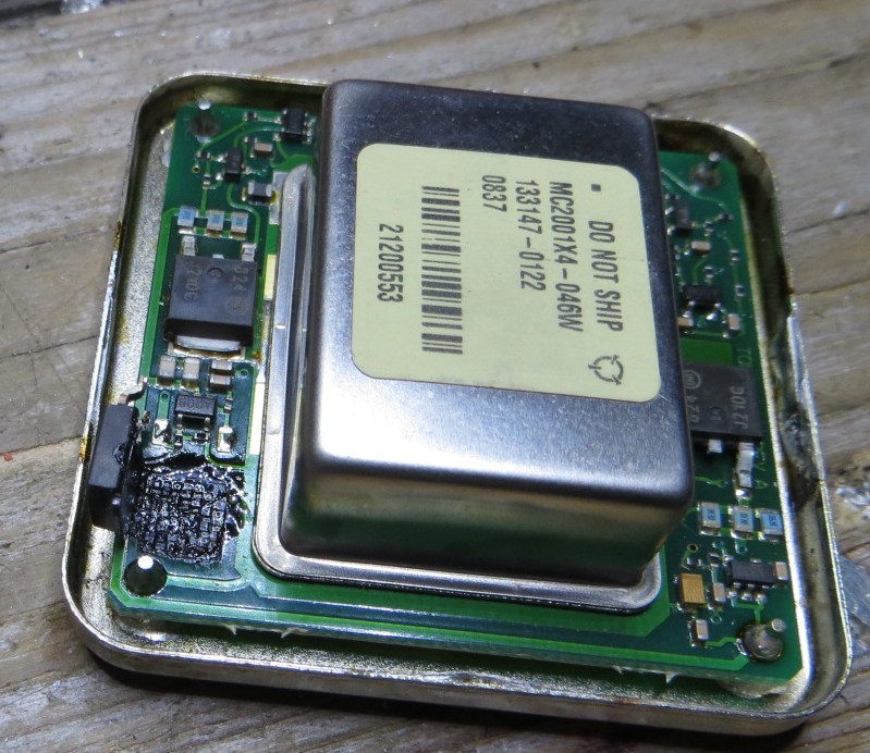

I powered it on, OCXO now dead. Still heating up, just no output. Same when out of circuit.
So I don't know what has caused this. Power is right way round! Nothing now on Vref and the 0.5v that was showing on the control pin has disappeared.
This is getting expensive way to fail!
I'm going to open it up and see what's going on.
Hmmmm
Got the top off with a heat gun. Didn't take long to find the culprit - see photo for where pcb is burned by a transistor. Amazingly when I took it out and tested it, it is still ok. I think it had melted it's connections to the point where it could come disconnected when I knocked the oscillator earlier.
Put it back, oscillator working ok!
Tranny got very hot very quickly when re-connected. I turned the supply voltage down, it cut off a bit above 3v.
So I wonder if this is actually a 5v version of the oscillator? It seems to run ok at 5v!

Looks like I should have paid attention to the other part number on it: tpn 57964-05. I think the -05 means it's 5v. Fnorking eBay seller listed it as 12v. Grrrrr.... Hope no other damage is done...

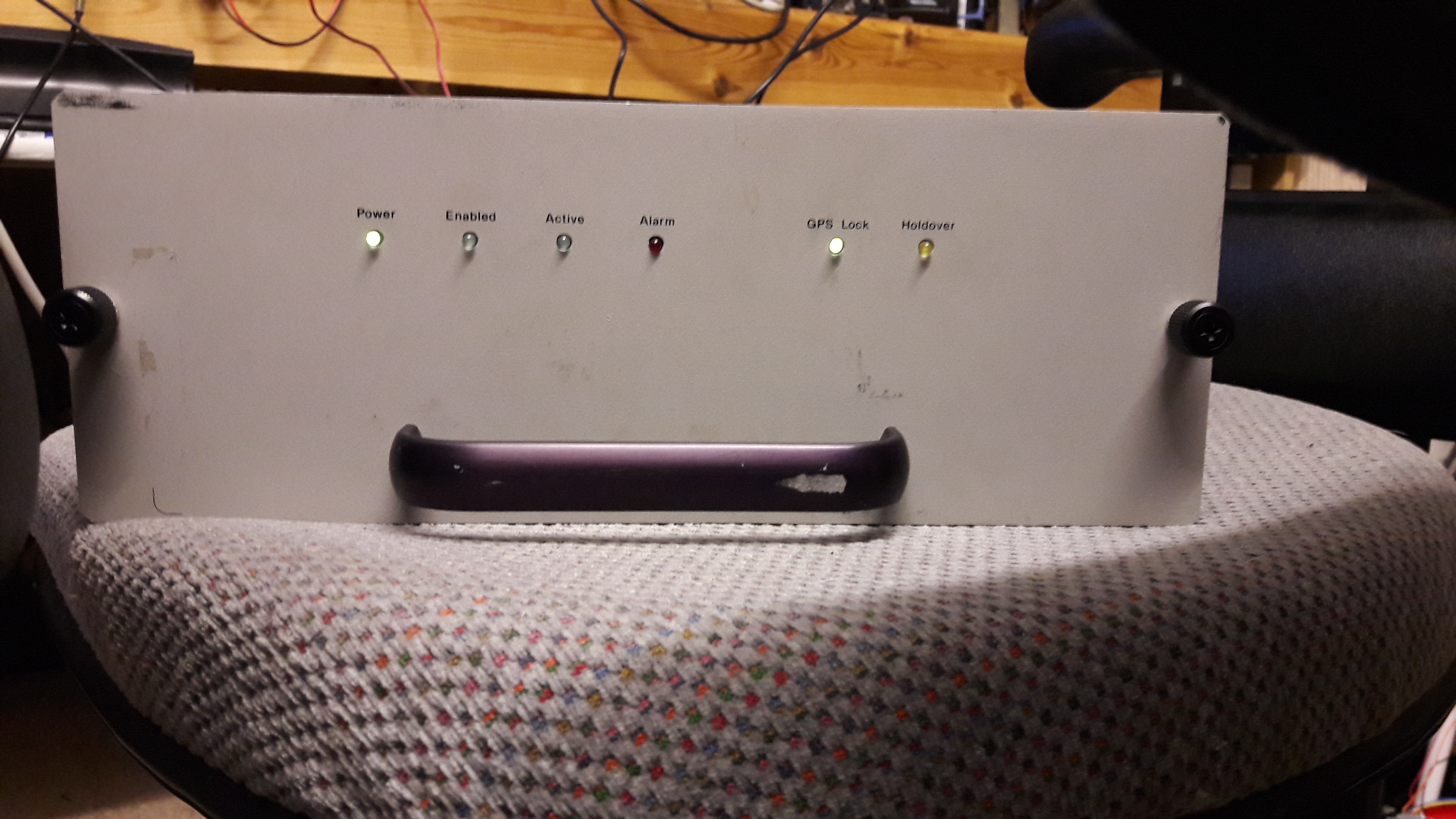

I got divers Gps frequency standard to work, last report via its serial port was saying its within 5nS, pretty close.
Ahh, blinkenlampen! Enabled and Active I can guess, but what's "Holdover"?
Power, GPS lock & holdover Leds are controlled by the gizmo's inside the unit, the enabled, active & alarm led's are just pilot's controlled via the serial port through on/off commands, I think they are provided to help comms engineers, pulling one of these out thats controlling a large mobile tower probably wouldnt do your boss relationship much good.
Holdover is an algorithm the unit has, it learns the control profile for the oven, ie records the control voltage over 24 hours, then if the Gps signal fails it reverts to holdover where basically it plays back the control voltage over 24 hours, maintaining an accurate timebase without a Gps signal, they claim its very accurate, and I think that explains a lot of the complexity of the device, not something I need but I spose you dont want a mobile tower shutting down because its really cloudy or something.
