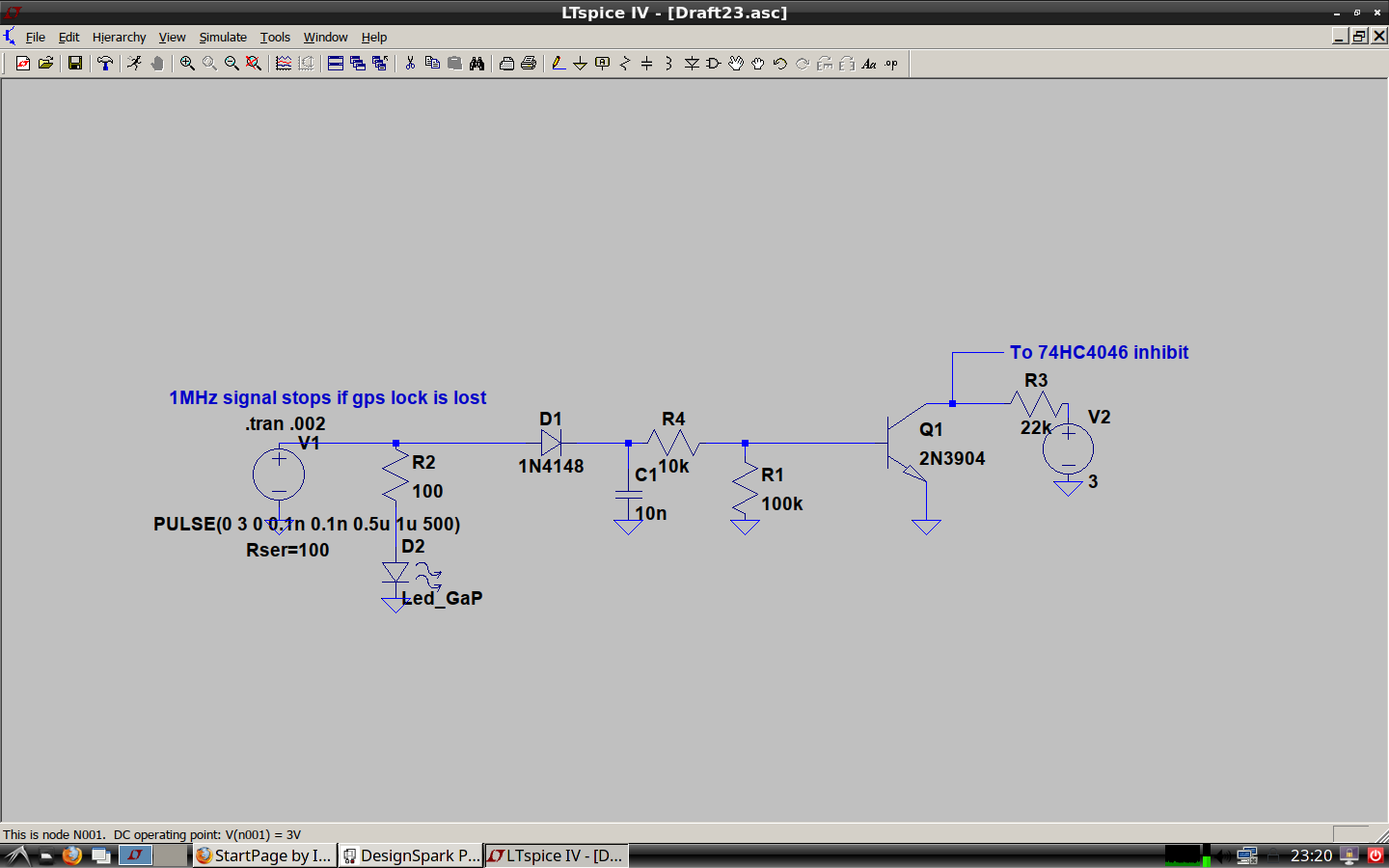

If the PLL is missing it's sigin input from the GPS, I was under the impression it detects this and stops adjusting the output, but apparently not, it just adjusts to the lowest level. So I need to make a detector that can turn off the PLL if there's no GPS. Hmmm. Could also warn if the GPS has lost its settings by flashing a PPS LED. I'm going to need a bigger PCB. OTOH, I've already got a few components on the other side and was thinking about flipping more, so maybe that's the way to go.

I was thinking to use a diode detector like for AM except it just outputs DC. It could drive an LED via a tranny. Off = no GPS, on = signal good, flashing = re-program needed because it's now at the default 1PPS instead of 1MHz. Though I guess I might need an extra filter for that. The GPS module has a LED built in to flash when it gets the 1PPS signal - don't know the effect it would have on the 1MHz that's replacing it - so it's possible it will do the job all by itself. If it does I could run a light-pipe from it to the front. Or use a photo-transistor to pick it up. Oh but I'd still need the detector to turn the PLL off.

This works in LTSpice. I have to wait for new GPS module to test it for real.

Looks Ok.
However I seem to remember theres something goofy with the enable i/p on the 4046, certain manufacturers version that is, Pc2 doesnt go high impedance when the chip is disabled on some devices.
You'll have to play with it & see, preferably before you etch a board.

Oh ok, thanks for the heads up on that! Is that just the original or are the 74 versions affected as well? I'll have a play anyway. It may be a significant stumbling block because I'm publishing the project as an Instructable, I wouldn't want other people to end up with something that has a hard-to-spot fault. I suppose I could switch the OCXO output to both inputs to achieve the effect or pull them both one way or the other.

(Edit) Oh wait - I've got the PCII output going back to the VCO input anyway, it uses DEMout to drive the oscillator's control pin. Inhibit definitely controls that one! I'm assuming the output goes hi-z because it's there to minimise power consumption. I just never thought to check! The oscillator's control pin does have a voltage on it, about 0.5v in this case, so I guess it will tolerate some resistance there, just don't know how much.
Well I did the experiment - a while ago now. Once the inhibit pin is high you can see the voltage going back to whatever the oscillator is it at on the output. Replacement GPS module arrived a couple of days ago - taken long enough! So I can test properly now. Also got an antenna to stick in the shed roof. I'm going to assume the thin roofing boards won't have much effect on it (don't trust it being outside). Been trying to figure out how to get the "survey in" function to work (for fixed location devices). Just sits there not getting any coordinates. It's one job where a micro would come into it's own, running routines like that. Not that I'm going to bother else I'll never get it done. Well, maybe one day.
