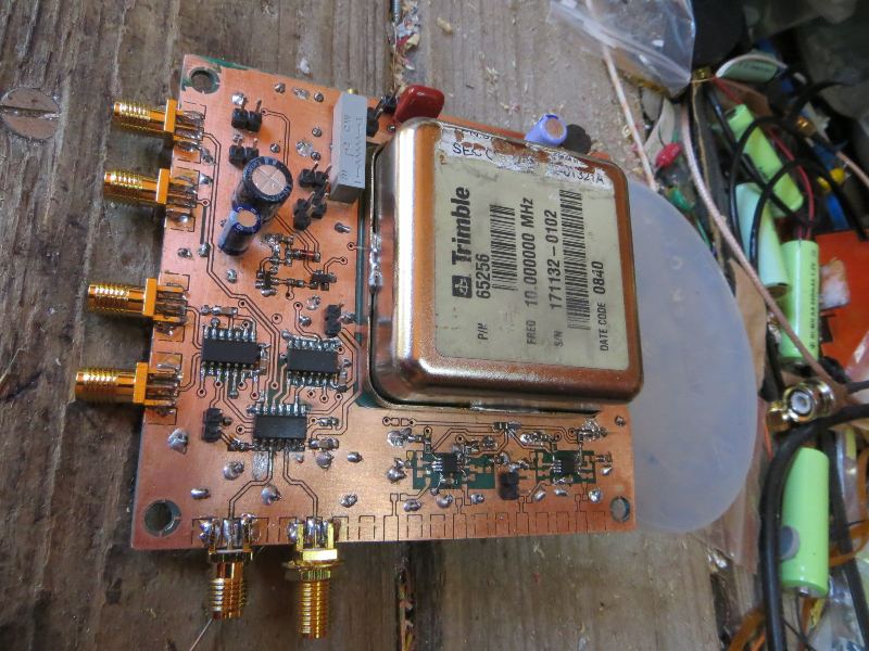

It's coming along nicely. I made my first ever plated-through-hole pcb for it. There were some mistakes, like deciding this was the time to experiment with a longer pcb exposure time - leading to bridged tracks and spread pads (on the msop chips - ouch!), relay footprint is mirrored so had to put the relay on the bottom of the board (and very glad the PTH worked on /those/ holes!) got the inverter connected the wrong way on the divide-by-10 - don't know how that happened but it's annoying I must have looked at it dozens of times and not noticed!
Seeing some noises on the tops and bottoms of the square wave outputs but it could just be an artefact of my flakey test gear.
I'd changed the diode orientation on the lock detector because it worked better on the perf. board, but think I need to change it back again.
Changed the LPF at the input of the distribution amps for a ferrite bead. It's dropping more signal than I hoped. Have to try some others. Might have another go at the LPF, need to wind a 1uH coil for it, is a pita.

There were supposed to be areas clear of copper under the chips but I lost the copper-keep-out areas from 2 of them and didn't notice until I'd etched the board. I'll try and carve them out now I've seen what's going on. Looks like I have a slight de-coupling problem too, so maybe chuck in some different sorts of caps and see what happens.
So what I'm seeing on the TTL outputs is over-shoot and a bit of ringing on the rising edge, slight ripple on the top of the square, and some rounding off of the corners of the falling edges. The 10MHz output has very strong over-shoot, but if I connect it through the 'scope's 50ohm input it goes quite rounded instead, but I might be seeing a limitation of my 40 or 50 year old 40MHz 'scope there, in need of adjustment as it is. Maybe I should put some 1k resistors across the outputs and it'll come out right.
So is there a straightforward fix for the peaking and rounding?
Photo of construction so far. The PLL chip is on the underside of the board with a few other bits.

I did, but it wouldn't go quite right. I did eventually reveal a certain amount of ghosts, the overshoot and ringing aren't nearly as bad as I thought they were. I think you are right about pushing the 'scopes limits too. It's a 40Meg CDU150 so the fast parts of a 10M square wave will be beyond it's limits.
Outputs are just TTL except the 4 analogue amps which are back-terminated.
To be honest as long as they're clean I'm not terribly bothered if the square waves aren't as square as they could be, whatever those outputs get connected to will sort it out anyway.
I'm re-designing the board anyway to make it more RF-friendly, correct some mistakes and put in a couple of changes. And to see if I can better THP!

I've been reading up, and found my problem with overshoot and ringing is due to bad board design. I thought I was doing the right thing by removing ground plane under the digital output traces to reduce capacitance, turns out it has the effect of increasing inductance! Finding some other changes I need to make too. Just down to inexperience and having to learn as I go along.
Main thing now is to make sure it does actually lock in properly now it's on a PCB instead of perf-board. Flakey wiring is no longer an excuse!

Well, I ran it all day today, still didn't stabilise.. Need to change the loop filter. Seems the lock indicator LED is affecting the control voltage when it goes on and off too.
Yes I had troubles with the loop filter, by far its the most difficult bit.
I pinched some ideas from existing frequency standard projects on the net in the end.
Really you should have 2 power supplies, one for the osc & Pll, & one for eveything else, you'll probably find too that when you connect a load to the o/p it too will send the frequency on a bit of a wobble.
I odnt think you need to go as far as optically isolating everything, however a high value resistor driving a tranny on a seperate rail ought to improve things, start grounding with heavy traces/wires is also a good idea.

At the moment the osc has it's own PSU with regulator, the other 5v supply is split in 3 using 10 ohm resistors each with it's own filter and bulk cap so the digital chips and PLL share a branch, the GPS has a branch and the analogue amps have a branch.
I can see the sense in putting the PLL on the same supply as the osc though. I never thought of that before.
