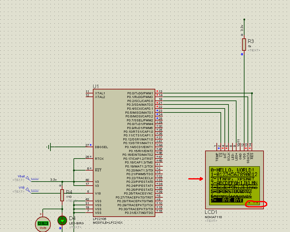

hi, everyone. I got to this thread through google. I have been working on the same display over the last couple days and would love to share it with folks here and get some help as well.
My code came from a CCS package I got on the web. I then adapted it for PICC (12f675) and then I decided that for what I wanted to do (as a prototype of a little portable scope), I needed something faster. so I went to ARM7. the code is compiled under Keil uvision3, mdk3.70.
I haven't figured out a way to post code so I will just put up a picture of the program running on proteus.
it works fine but has trouble displaying lower case letters some of the times so I am working through that right now. the display allows attributes (normal, overline, underline, strike, and reverse) to be attached to each string to be displayed.
two issues with the program now:
1) it doesn't display some of the lower case letters some of the times. see the red arrow. it should have displayed "hello, world", all in lower case but it is been shifted by 1 letter.
2) it has some remaining lines on the last line (page 8, d0, per the datasheet). now sure how data go there.
i will post the code once I figure out how to do so.
