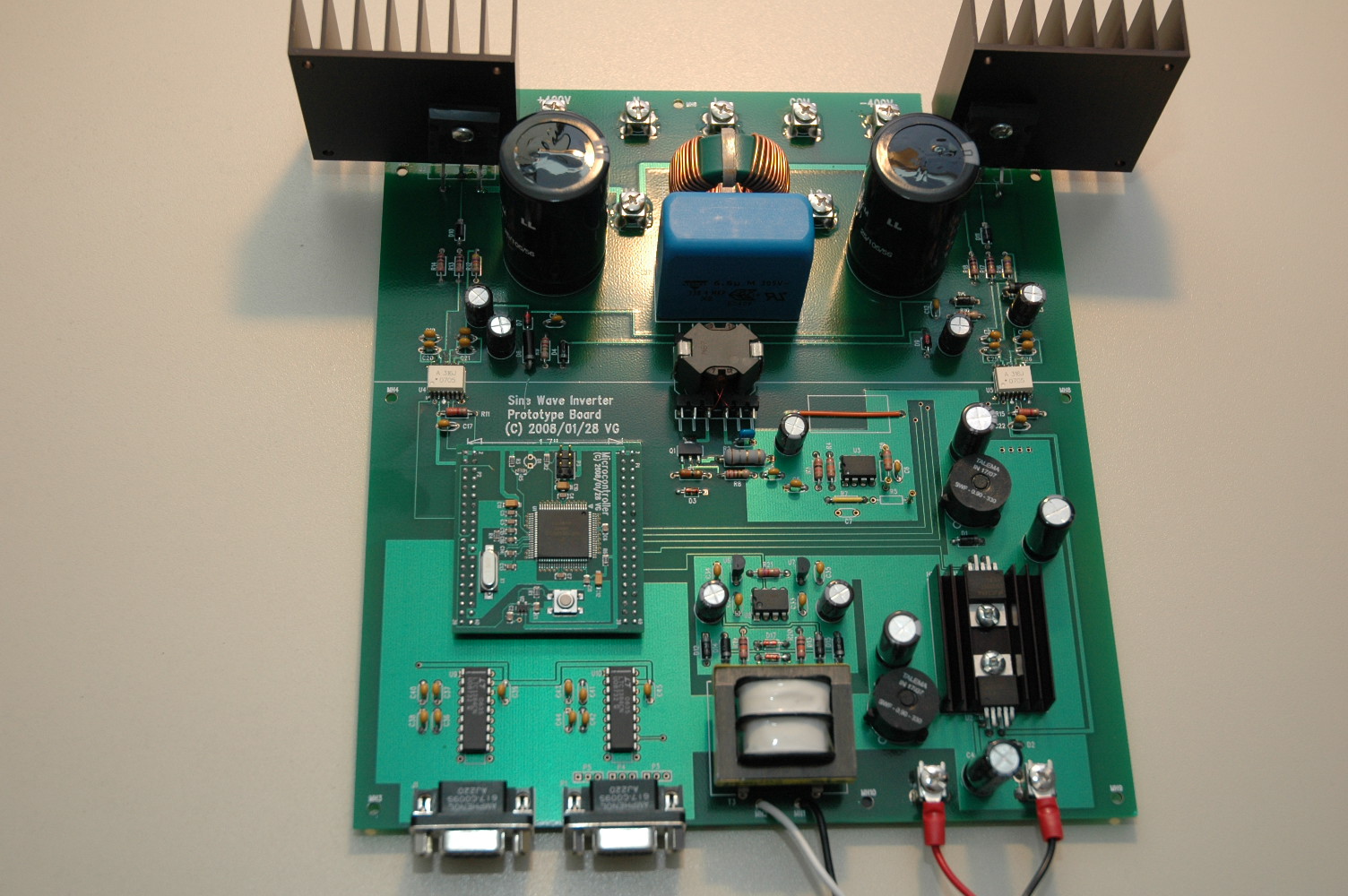

I got the the PWM software working and scoped the microprocessor output to see that it was locking-in with the power line. Everything looked good. I then got busy with a couple of large projects and put the Inverter on the back burner. I never got to power up the high voltage section. I am not so busy this year and might resurrect this project. I am glad to see that there is lots of interest in this area.

Vakl;
What a beautiful and professional looking board you got there.
Hopefully you'll be able to finish it succesfully.
How much pwer do you calculate your IGBTs will be dissipating?

Thanks Fernando
I don't know how much power the IGBTs will be dissipating. I may find that at a switching frequency of 60KHz the power dissipation is too high. Since this is a software driven device, the switching frequency can be reduced easily. The cost is a slightly coarser sine wave.
