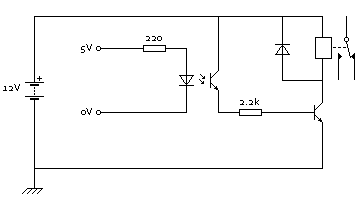

Hi everyone,
I m doing relay operation using micro controller.
I have one problem is that, I have +24 Vdc & gnd for power supply.
Two types of power supply i used. i.e. one for microcontroler i.e. +5 V using 7805. & other
one is for Relay supply.
So, problem is that i want to seperate these two grounds but i have only one ground.
So plz suggest me any idea.

Use a opto-isolator on the output pin of the PIC to isolate the relay driver transistor base

No no. My relay operates on 12v. My problem is that, i want to seperate "relay ground" & "controller ground" but I have only one ground with 24V dc.

So use two regulator IC, a 7812 to get the 12Vdc and a 7805 to get the 5Vdc.
Just use separate wires (or traces) from 24Vdc/gnd to the two power regulators.
In this way, you'll minimize the effects of the relay spikes.
Using two regulators would mean you have to connect the grounds together.
Here's how to use an opto-isolator.
If you want to power a 12V relay from 24V just connect a resistor in series with a similar value as the relay coil's resistance.
For example, if your relay is 250R, connect a 220R to 270R resistor in series with it.
If you don't know what the the relay coil resistance, look at the datsheet or measure it with a multimeter.
