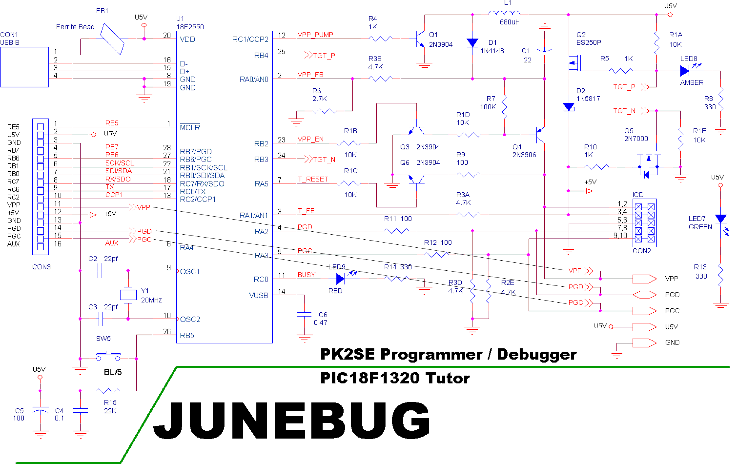

But some questions about junebug:
1: What is the purpose of 16 pinned CON3 ? Can I ignore it ?
2: What is the purpose of SW5 ?
3: What is the purpose of FB1 ?
4: Junebug doesn't need any external power supply. So, why there is the lebel "+5V" beside the 12 pin of CON3 ?
5: Will I need to connect the VPP, PGD and PGC from CON3 to CON2 (As I marked in the image)?
Thanks to all.
I WILL GO FOR JUNEBUG. The last and final decision here.
If all you want to do is program PICs you can ignore it.
To program serial EEPROMS you need the first 6 pins.
The Junebug and PICkit2 use different ICSP connectors. The Junebug Version is the
5x2. The PICkit2 is duplicated by the first 6 pins of CON3.
It has several purposes depending on the microchip software in use.
Pushing it while you insert the USB causes the bootloader to look for new software.
Pushing it while in the LA tool causes the LA to stop looking for a trigger.
Pushing it while in the program and go mode causes it to program a chip This one
I have not done and the JuneBug needs to have a serial EEPROM added to make this work. The program and go mode is not often used in the hobby or learning setting.
It cleans up the power from the USB port. It can be omited.
Think of that as +5V out.
No.

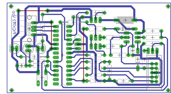

Can somebody tell me, If more than 5V (ie 5.2-5.8V) and less that 0 (ie -0.5 to -1.00) is supplied to the programming pins of a PIC (except the MCLR), will it cause damage to it?
Hi theo have you experience in making PCBs?
Have you used Eagle before?
I'm also don't have those programmers I don't have money to buy them.
I'm also going to make a PICkit2 clone.But I have drawn some programmers using Eagle.
Will it scare you?
If you like we both get together & make that programmer.
My one is something like this.Before making you need to recheck with PICkit2 Lite & with Junebug.
This is a combination of PICkit2 Lite & Vpp control in Junebug.
Give your email address I cannot post here because its not a good idea to post it here.
