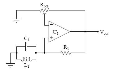

I was hoping to get some guidance on which direction I should go first on designing a circuit for finding LC resonant frequency. I am not sure if such a circuit is in the public domain somewhere, but I have been unable to find one so far. What I am trying to do is build a circuit which is able to maintain resonant frequency in a LC tank even if the capacitance or inductance changes. For example, a circuit which constantly samples the voltage across the capacitor and inductor for peak voltages and makes adjustments in frequency to maintain peak voltages. Thanks in advance.

If you are talking about an oscillator tank circuit, then a phase lock loop would solve the problem. If you mean a receiver tank circuit a possible solution would be possibly an FM AFC circuit.

Why not just make the tank into an oscillator circuit? That will automatically generate the frequency at the resonant point.
I wish that I knew how do design a circuit that does that. What I was hoping to do is drive a LC tank at its resonant frequency. The problem is that the inductance is going to be changing somewhat periodically. So I need a circuit that will detect the change in the resonant frequency of the tank and adjust the driving frequency up or down and drive the tank at the new resonant frequency.

Perhaps you could something similar to this LC oscillator circuit. It should oscillate at the resonant frequency of the tank.
I am not sure if it matters that the tank I am using is going to be in series resonance. But the big problem is that I am not exactly sure how to integrate that op amp into a circuit that drives a frequency back through the op amps input tank. Thanks again.

I don't understand your concern. The circuit will automatically oscillate at the resonant frequency, which is what I thought you were looking for. Are you trying to do this while the tank is part of another circuit and that's why it's in series resonance? Otherwise the resonant frequency doesn't change if the tank is in series or parallel.

Certainly it's relatively easy to vary the frequency up and down and look for the peak voltage. This can readily be done with a microprocessor. It would be programmed to scan or dither the frequency slightly and observe the peak voltage to keep the frequency at or very near resonance. As soon as it detects a drop in voltage, it reverses the frequency scan direction. (A similar method is used to keep scientific satellite dishes aimed for maximum signal). Many µP's have a D/A output which could control a VCO (voltage controlled oscillator).
That would likely be a lot easier than trying to do it with discrete IC circuits.

My feeling is that, since there's a sequence of events that need to be perfomed involving making decisions, it seems like a discrete design would be fairly complicated. Offhand, it would require a sweep circuit, a method of detecting the peak voltage (perhaps a differentiator), some comparators to control sweep direction, etc.
