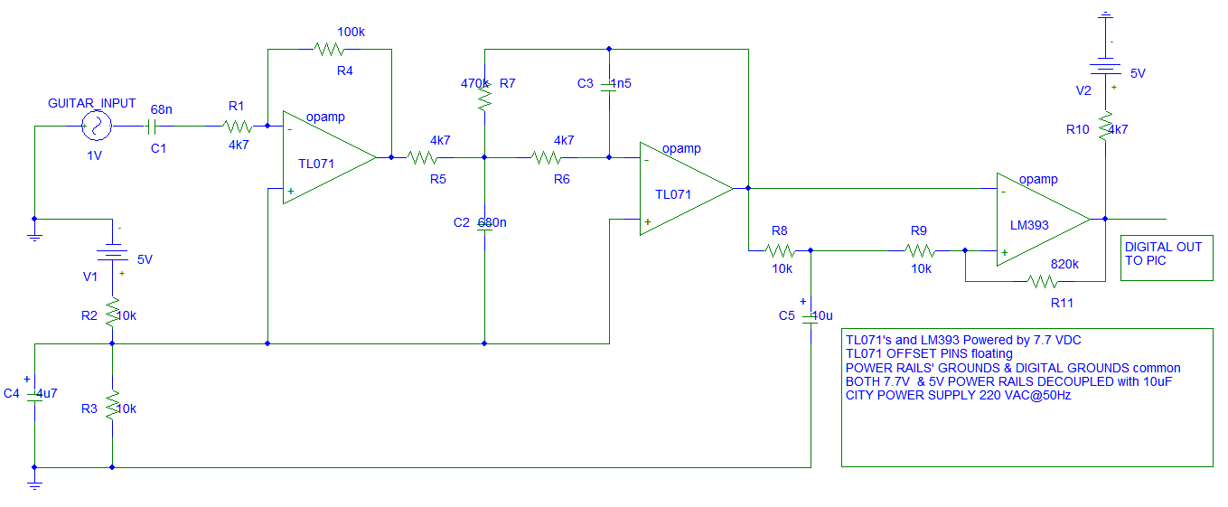

here is the filter that I'm having problem with. This thread is as a follow up from "2 x TL071 = TL072??". I can not get any audio after the comparator, am i not supposed to? i remember audioguru tellin me i should get a very distorted sound, yet that was with schmitt trigger.
also the original design had a 16u cap for C5, is replacing it with a 10u going to make a huge difference? (btw just to make it clear C4 and C5 are electrolytic)

what's the reason behind supplying 2.5Vdc to positive inputs of the TL071's btw? This circuit was redesigned with reference to nilS thegimmick btw.. and he referenced it off some german guy...

"R2/R3 divide the +V1 into half [the centre point of the +V supply] By applying this Vss/2 to the TL opa NI inputs , this sets the operating point of the opa's OUTPUTS to V1/2. This means without an audio signal the opa outputs sit at +2.5V, so any audio signal will drive the opa down towards 0V and up towards +V1.. This means the signal will be symetrical about +2.5V,,, this is what you want in a 'ac' amplifier, when its only got a single power supply line [+5v].
The C4 is just noise decoupling of this centre point voltage.
C5 will act as a filter with with R9/10. The LM393 comparator has positive feedback R12, so R9/10 C5 and R12 work together to determine at which voltage point on the audio signal, the signal is squared up by the LM393.
This clears a lot of stuff up for me; except one :eek:. If anyone could explain how the comparator and that part of the circuit works? with a little equations incorporated if possible.

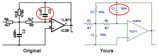

Why are there so many threads about this circuit. I wish it is in a single thread so I can see the original schematic. I searched and found the original schematic.
1) the value of C3 is 453 times too high.
2) The minimum supply voltage for a TL071 is 7V. This circuit has only 5V. The opamps might not work.
3) A guitar pickup is designed to be loaded with 1M to 3M. Usually a vacuum tube or FET is used. This circuit has 4.7k which is like a dead short and will reduce the output from the pickup a lot.
If the capacitor value is corrected, if the opamps work and if the pickup has enough output then of course the output of the comparator is a square-wave. The comparator is a schmitt-trigger.
The value of C5 is fine if it is 10uF.

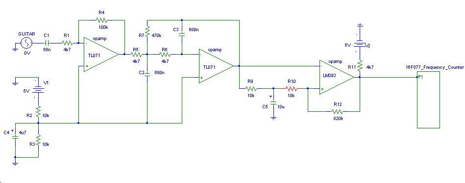

Eric explained how the comparator works:
A comparator switches its output low when the voltage on its (+) input is lower than the voltage on its (-) input.
The output goes high when the voltages are reversed.
R12 provides positive feedback together with R10 for a snap-action Schmitt-trigger.

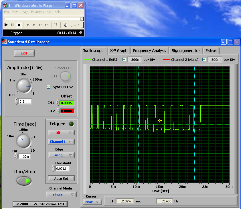

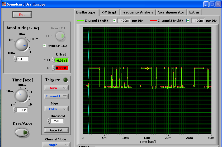

I rebuilt the circuit with +7V power supplies to LM393 and TL071's which got my circuit working!! But I'm getting some inconsistencies; such as a 100-120Hz and sometimes 600-620Hz square wave when there is no input. The range that I'm interested in is 50-380Hz roughly.
First of all, I'm thinking that this circuit is a 3rd order low pass filter, so how is a 600+Hz signal is even passing through to output?
Secondly,when I get the 100-120Hz noise it's a big problem because it's in the range of frequencies that I'm trying to analyze. When I generate ~82Hz (low E) recorded guitar signal, the oscilloscope sees about 160Hz.
FYI - I do not own a proper oscilloscope, I use my laptop and Scope software, with coaxial cables coming out from headphones as signal generator and mic as scope. The coaxial cable had solved my noise problems previously coming from my magnetically crowded room.

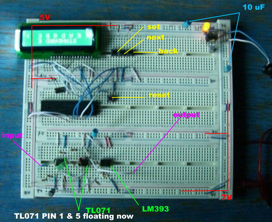

What can I be doing wrong? My friend suggested that I move my circuit to a PCB since the protoboard's grid might collect a lot of EM, but I'm still in the prototyping phase!

What power rail decoupling do have on your project board.?
Is it possible to post a picture of the project board, so that we can get some idea on how its laid out.

I'm not too familiar with what power rail decoupling is supposed to be like exactly. I have one rail fed directly from a power supply ~7-8V, other rail going through a 7805, grounds are connected to each other. Is power rail decoupling like a capacitor between ground and power to get rid of AC? I think I just placed a 10uF electrolytic for the 5V supply, and nothing for the 7V.. oops i guess?? What values should I use?
I will post a picture when I get home. I will this time... like for real! :)

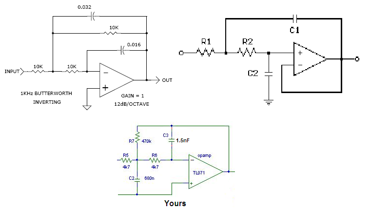

I have never seen a second-order lowpass filter like yours. It might be a simple bandpass filter if it was wired a little differently.
Here are two second-order lowpass filters:

Just to clarify things; here is what I have, and what I'm experiencing with my circuit:
Updated schematic
Image of circuit
Static noise my computer stopped analyzing to the right of the screen here because it slowed down due to print screen command
Noisy output 81.81 Hz btw, sorry for the crop

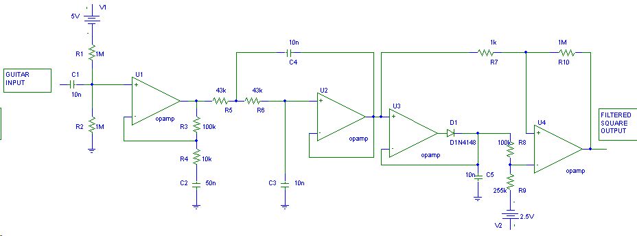

I also came across another design, the schematic was hard to read so I redrew it, the values might be incorrect. If they seem out of place please let me know. Is this the kind of filter + comparator combo, I should be going for??

For the 2.5v power supply-I think feedback?- connecting to U4 opamp, can i just use any value R's for a voltage divider on 5V to achieve 2.5V, or would the resistors screw up the response of the last opamp - which i think is functioning as a comparator? - ?
I think I should also move to a quad opamp to save some space since this is supposed to fit inside a guitar.

You changed everything:
1) The original circuit has a 1M input impedance. Yours is 500k.
2) The original circuit uses a 1uF capacitor in the gain setting parts for the 1st opamp for a low cutoff frequency of 16Hz. Your 50nF capacitor for C2 has a low cutoff frequency of 320Hz. It will have a flat response down to 1.6khz.
3) The original circuit has C4 double the value of C3 to make a sharp Butterworth response on its lowpass filter. Yours has equal values which makes a droopy Bessel filter.
4) The original circuit uses 100nF for C5. Yours has only 10nF.

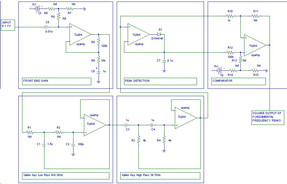

Self Intervention
I did some calculations on my own this time to create my filters. The real important one is the low pass. I think the capacitors I have chosen will make a sharper curve. The high pass filter is there as a precaution and serves as a barrier to only pass through the frequencies I am interested in. The rest of the circuit has been taken from 5-string bass tuner from electricdesign that u can find at the bottom of the first page of this thread.
I hope that this will be an effective design, I took care to have high input impedance and to choose the right sized capacitors for my low pass filter to get a sharper curve.
What I learned from this project is that one is better off understanding the filter concept and creating his own; makes everything so much clearer. Also, boxing and labeling separate parts of your design helps you understand the flow mechanism.
Now, I am TRULY ready for your already appreciated inputs.
