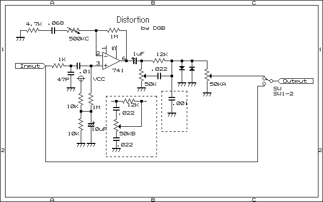

Hi all,
I urgently need help with this distortion pedal that I want to build. I'm quite inexperienced and any electronic education I do have is directly taken from Grade 8 science textbooks as I am only 14.
Here is the diagram:
I got this from Schematic Diagram - Free Schematics Download. There it says that it's a boss DS-1 but it isn't. Anyway, this is my first time building a circuit of this level of complexity from a circuit diagram and I need assistance. To the left of the image is a symbol labeled VCC, and I don't know what exactly to do with that. I'm also not sure about what to do with those "Earth" symbols, do I just solder them to the metal casing of the pedal??? Another question I have is what type of capacitors should I use for this. Is there a specific type that suits it better than others?? And lastly, at the input and output, which terminals of the jack sockets do I use???

VCC is the positive supply, which is also attached to the (+) (pin7) of the 741. They also forgot to show the (-) from the battery is connected to pin 4 of the 741 as well as the earth symbols. Oh, and they forgot the battery.
Connect earth to the shield of the input and output wires, and to any metal (case?) of the unit. The capacitors probably aren't critical since this is a distortion generating circuit. I would use whatever I had lying around.

When you refer to the "positive supply" you mean the one from the missing bettery right? And I earth the input and output shield to...... metal basically but the other Earth symbols are just to show that it's connected to the negative of the 9 volt battery?
Thanks a mil so far
All of the Earth symbols are connected to the (-) of the battery in addition to any shields and cases.

The opamp is not powered and has no 0V connection shown.
Seems to me this schematic wasn't very well drawn up, or rather the components could be better.

The 4 avariable resistors, what should I look for regarding the different types of resistors. The lowest cost that would still be properly functional??
Normal carbon resistors, if that's your question, are more than enough.

I am pained to report that the helpful picture does NOT show a suitable variable resistor.
Yes in this circuit the cheaper variable resistors would perform electrically. The only other important consideration is how easy can it be accessed and of course that many cheap parts aren't built to tolerate a difficult environment.

A semiconductor amplifier that clips produces harsh distortion.
Diodes in parallel to ground in the signal path and fed through a resistor or in the negative feedback loop of an opamp produce square-waves with rounded tops and bottoms that have more "graceful" distortion.

A TL071 audio opamp is low noise, has very low distortion and has a full output bandwidth of 100kHz. Its minimum supply voltage is 7V.
An NE5534 audio opamp has very low noise and distortion, a wide full output bandwidth and a minimum supply voltage of about 5V.
