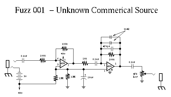

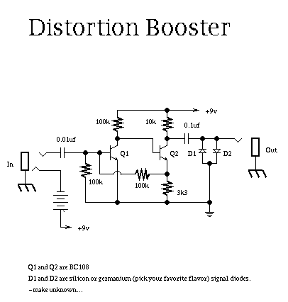

You're building a "distortion pedal", correct?
I don't know how far you've progressed with your "Distortion project,anyway,here are a couple of distortion circuits you may be be interested in.I think it would be better for you start with a simpler circuit to gain experience & not in the least more confidence!
I would start building these on a- "Breadboard"- these small plastic experiment/prototype boards.These are easily obtainable from any electronic shop or on the net. I still start all my new projects this way to make sure it works at all or not & to further improve on it.
These two circuits are fairly easy to build & test.Do not hesitate to ask if you need any help,as I am sure there are many in this forum who i am sure will readily give you very useful advice.
Good luck!

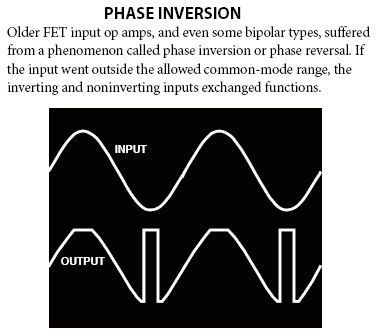

The older FET input opamps have the problem called "Phase Inversion" when the input voltage is too negative (because the input was over-driven). The output suddenly becomes high and it sounds awful.
Thank you for pointing this out! I in fact tried frantically to find some source that would state otherwise, but to no avail! he..he. I think you could be right about the origin,but what a paradox,in that the clone turning out more popular than it's master! As I've stated earlier,the TL071/72 are quite good, both performance & price wise. The TL072 is the chip I use mostly except for NE5532 which too is excellent for audio work,especially on the driver/output stages.
