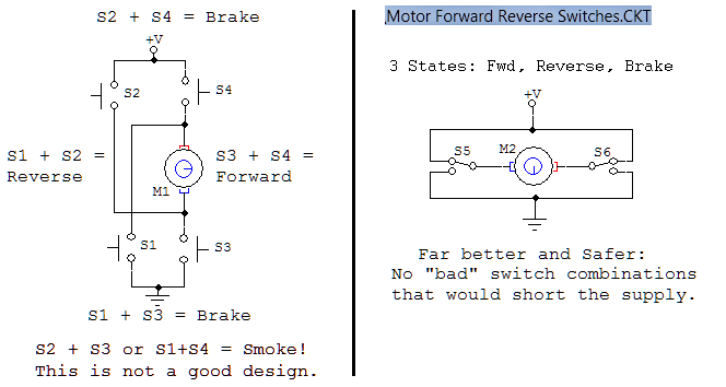

There are so many mistakes, omissions and non-standard symbols used on that page, that one would be better off to NOT look at it.
There are no formulas anywhere for the reader to determine the correct resistors to be used. Simply using 1k Ohms for everything is not acceptable; as the transistors would either not be in saturation, or excessive base current would be flowing.
Let's start with the 1st schematic:
The one on the left is fine. But could the one on the right be drawn any more cryptically? What was that person thinking when they drew that? Obviously, they were not!
Here is an improved schematic, which is much easier to understand; very important for a novice. I've also added a far better circuit which overcomes the shortcomings of the previous two circuits; it is at once simple, elegant and there are no combinations of the two switch settings that could cause a short:
motor-forward-reverse-switches-png.59754
Why didn't the author of that page include a circuit like that, instead of those with shortcomings?
