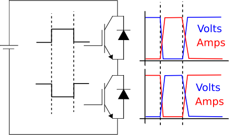

A H-bridge can be broken down into legs
For this single phase inverter
LEFT LEG is the upper and lower FET on the left (that are tied to D1 and D4)
RIGHT LEG is the upper and lower FET on the right (that are tied to D2 and D3)
The one thing that you must NEVER do with a voltage source inverter (that this is) is provide a short-circuit across the supply.
That can occur if you turn both devices on in a LEG, VERY BAD!!!!!!! more then BAD, it is dead FET's, IGBT's, GTO's, BJT's...
Such an event is called a Shoot-through

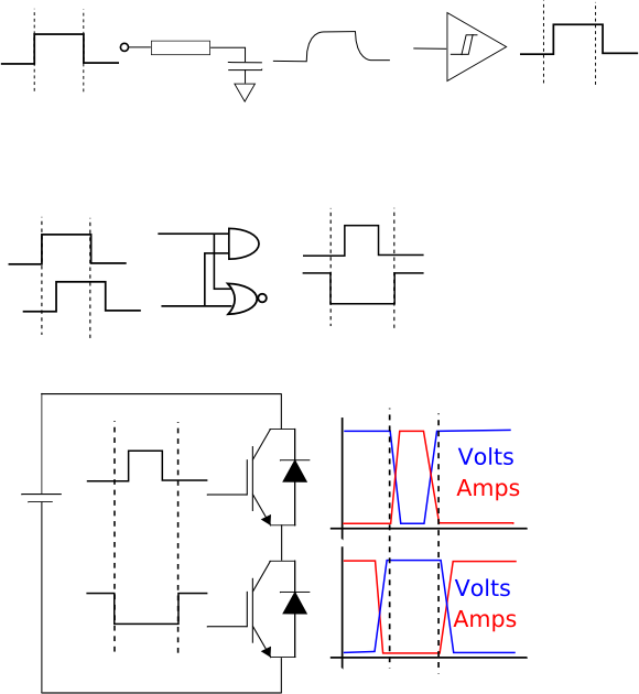

There are two types of shoot-throughs
1) Commanded. You have no purpose EVER to turn an UPPER and a LOWER Switch in the same LEG on EVER!!!, but if there is a problem in your control (something you overlooked) you could turn both on. This situation is very bad
2) switching: In a phase LEG the UPPER and LOWER switches are fed the compliment PWM signal (so they are never commanded ON at the same time). However, switches do not turn-on/off instantaniously, it take time
IF you command the upper to turn-off and the lower to turn-on at the same time (or vica verca) then there will be instances where you have provided a path for current to flow through a leg BAD!!!!!!!! the current flowing will not be as bad as if it was a commanded shoot-through (since the devices are transitioning between states) but the killer is, that the switches in this condition are in their active region, big volts and big amps POP!!!!! too much power BAD!!!!!!
To get around this drive designers add a time delay between the upper and lower device (dead-time, interlocks...) such that this cannot happen (well it still can but at extreame temp and other situations)
This might help explain it:
