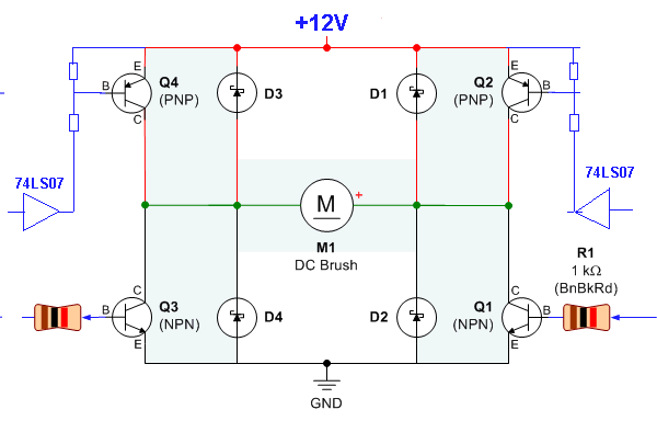

I built an H-Bridge using this diagram
Bipolar Transistor HBridge Motor Driver - Robot Room
I changed the NPN transistors for IRF520 MOSFET's
https://www.futurlec.com/Transistors/IRF520.shtml
I changed the PNP transistors for IRF9Z34N MOSFET's
https://www.futurlec.com/Transistors/IRF9Z34N.shtml

I have 2 separate voltage sources, 1 from the Ardweeny and 2 from the Wall Wart DC REGULATED 12 Volt power supply.
Both Power supplied are connected by GROUND, The Wall Wart powers the motor, The Ardweeny +5volt powers the base of the transistors.
Now when I hooked up a battery pack which is 3Volt everything worked fine. When I changed the 3Volt battery pack for my 12volt Wall Wart I get instant overheating transistors and they go up in smoke.
I have tried several transistors, MOSFET's and varying voltages and once I try to use the 12Volt supply its game over.
Any help is greatly appreciated, I feel like I have a good understanding of NPN transistors but PNP transistors make me insane.
A quick look at the circuit links shows then when powered from 3V you are able to control the upper transistors from a 3v/5v drive signal, but when powering from 12V you cannot switch OFF the upper pair

Say the top fet/transistors had their source/emitters connected to +12V, for a transistor to turn OFF the Base would have to go to +12V, I guess your driving signal goes to +5v max, so there is still +7V on the gates/bases, so they are still ON
So when the bottom pair are switched ON there is a short thru one of the top pair to 0V via one of the bottom pair.
If you change direction the other pair are shorted thru.
You need 5V to 12V levels shifters

Have a look at this option.
It uses a 74LS07 non inverting o/c IC for level shifting

So your saying I should use the resistors to pull up to +12v when not in use and then use the 74LS07 for -12v when I want to turn on?
Couldn't I just use a couple cheap NPN transistors in place of the 74LS07 ?

A transistor would invert the signal you dont want that.
Its a +12V OFF signal and a ~0V signal ON at the upper transistor/gate, not -12V
Are you going to use transistors or FET in the bridge
Your IRF520 Mosfets need a gate voltage of +10V to properly turn on but you are feeding only +5V so some will not turn on well.
You should use logic-level mosfets that turn on well when the gate is +5V. Use IRL520.
The gate-to-source voltage on a Mosfet of 0V turns it off. So if the source of a P-channel Mosfet is +12V then the gate must also be +12V to turn it off. Usually a resistor from gate to source turns it off when the resistor is not driven from a level shifting transistor.
Your circuit has +12V, +5V and 0V. It does not have -12V nor -5V.

VGS(th) Gate Threshold Voltage VDS = VGS ID = 250 µA MIN 2 AVG 2.9 MAX 4V
I thought that meant 4V MAX for the gate, where are you getting 10 Volt from?

The on-resistance is spec'd and is low when the gate-source voltage is 10V. So it needs 10V to properly turn on.
The Gate Threshold Voltage is 2V to 4V when the Mosfet is almost turned off conducting a current of only 250uA (0.25mA or 0.00025A).
If your Mosfet conducts only 250uA when its gate-source voltage is 4V then maybe it will conduct only 10mA when its gate-source voltage is 5V. But it will conduct many amps when its gate-source voltage is 10V.

The TIP106 is a PNP darlington power transistor with built-in resistors that will turn it off when your level-shifting transistor turns off.
The 5V max allowed emitter-base voltage rating is when the emitter-base voltage is backwards in your circuit which will never happen.
