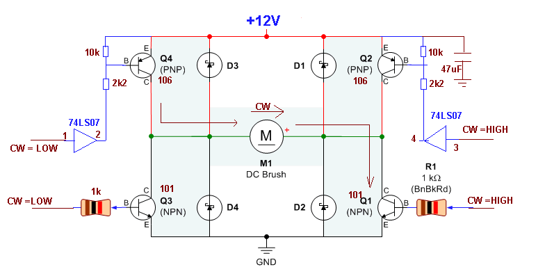

After I went home last night I did some testing and found out where I was getting confused with the transistors / MOSFETs.
The transistors I have only need around 2.8V to be fully saturated, I didn't know the FETs would be different and that the Gate Threshold was the voltage at which the FETs just started to turn on.
I did play with the 520's more last night and I noticed no difference when I applied 4-10 Volt to the gate, In other words I received the same power through the FET. This is likely because the motor I am using draws very little current.
Another thing I never noticed before is this
If I apply voltage to the Base of one of my transistors power will flow, if I take it away it will stop
If I apply voltage to the Gate of one of my FETs power will flow, if I take it away it will continue to flow until I change the Gate to Gnd or Pos depending on if it is a NPN or PNP.
This sheds new light on the FET H bridge and tells me that the Gate's can NEVER FLOAT, they must be pulled high or low even when not in use.
I do understand the PNP issue I was having also, I recreated the circuit and I noticed when I hooked the PNP Base to the Micro-Controller it would NOT SHUT OFF, If I understand correctly it is because the transistor needs +12 on the Base when the transistor is to be off, the Micro only supplies +5 volt which isn't enough to shut the transistor off. So now I understand what you mean when you say the top (PNP) transistors are not shutting off.

"101 and 106" are meaningless numbers. Maybe you mean TIP101 and TIP106 darlington power transistors invented by Texas Instruments.
Their max allowed current is 8A so they are pretty big. But you said your load's current is small so smaller transistors could be used instead.
Each darlington has a voltage loss of about 0.8V to 1V at low current so your load will get only 10V when the supply is 12V.
If you use Mosfets instead then the load will get the full 12V.
hi burners,
This is one option, the TIP's are an overkill for such a small motor.

Sorry I was referring to the parts I posted yesterday so I didn't think I needed to put the TIP before the numbers.
I only have the TIP's I posted and the IRF MOSFETS and I think the MOSFETS will be harder to control since I need up to 10V to turn them fully on.

Well for now I am just trying to learn the H Bridge. I think for the final design I might go a different route. Like an integrated circuit style H Bridge or maybe a DPDT Reed Relay.
I don't think it needs to switch from forward to reverse that fast, I mean the faster the better to keep the toy fun but I could sacrifice a little too.
What are some other methods to get this done? Remember the Voltage is 12 V but the motor draw very little current. Maybe I can put a meter on it when I get home tonight

A simple way would be a couple of 5V relays that could be controlled by the logic IC, that would give you OFF,FWD and REV [ at full speed]

For this simple app I would go for a couple of 5V coil SPDT relays, low current coils are available.
