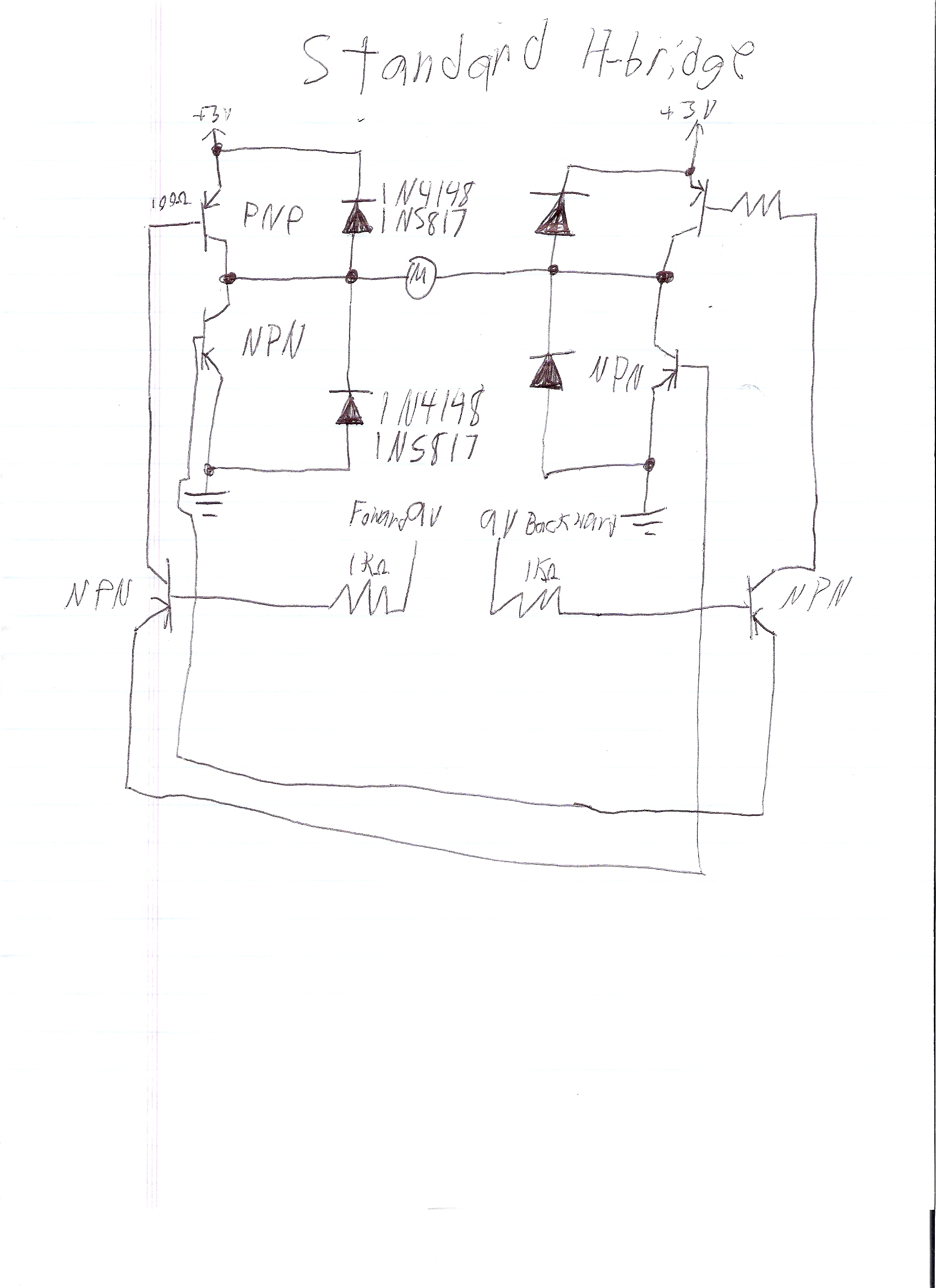

I am going to build a H bridge for my next robot, but I dont know what transistors or MOSFETS to use. They need to be able to power a motor that ranges from:
Minium requirements:
100ma no load
800ma stalled
Max requirements
500ma no load
5A stalled
I need some MOSFETS or transistors that can handle the minium requirements. I was thinking about using the 2N2907A and 2N2222A, but when it comes to MOSFETS, im stumped.

Lol, no i did not manage to figure out how your circuit works in the other thread. I dont know what the high side driver is. I dont know what a bootstrap cap is. The schematic Is shown in the attachment.
It is hard to see, but I am going to make another computer generated schemmy later.

You have the symbols of NPN and PNP transistors mixed up.
Your transistors don't have resistors to turn them off and no resistors to limit the base current into their bases.
A Mosfet is different from a junction transistor. The transistor needs 0.7V to 1V with a medium current at its base for it to turn on. A Mosfet needs to have 10V at its input to turn on.
The bootstrap capacitor doubles the supply voltage so that the gate of the Mosfet can be driven 10V above the normal supply voltage for the high-side N-channel Mosfets to turn on.

if you could referr me to a better H-bridge that closely resembles mine, please let meh know!

I think you're diving in at the deep end a bit here. I'm not meaning to discourage you if you're confusing bipolar transistors with MOSFETs and don't understand elemental terms like high side diver and bootstrap capacitor. I strondly recommend that you read some tutorials on MOSFETs, bipolar transistors and PWM before continuing any further.
