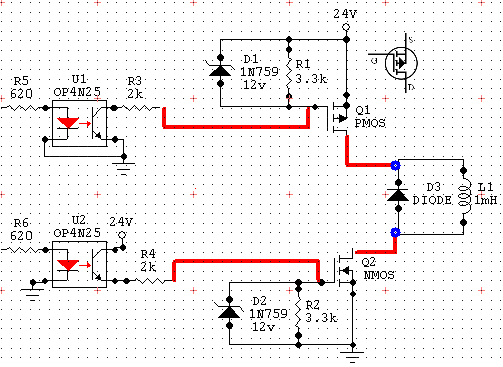

The Circuit below(Courtesy of SgtWookie) works just fine with the exception of the detail that the Pmosfet(an IRF 9540N) overheats excessively after about only 1 second of usage!
Any suggestion/solutions please?

The 2k resistors have such a high value that the Mosfets turn on and off slowly which causes them to get hot when PWM is used.
The opto-couplers might not be able to provide enough current for lower value resistors.
Each Mosfet can dissipate 100W if a huge heatsink is used.

Actually the only Fet that over heats is the PMos one and only if it is kept opened for longer than 1 second and, BTW, I am not using PWM with these. I guess the positive current at 24v and 2.5 Amps. is just too much but then there must be a way too. As for the 2k R's what is your suggestion then?

You forgot to look at the datasheet for the 4N25 opto-isolator. Its minimum transfer ratio is only 20%. So when the emitter has 5.8mA then the opto-transistor conducts a minimum of only 1.2mA and the gate-source of the P-channel Mosfet gets only 6.4V instead of 10V.
Use a 4N35 opto-isolator that has a minimum transfer ratio of 100%.
Being a NewBie I make a lot of mistakes amongst which to mention that I am actually using PC817 with 50%Current transfer ratio ( CTR: MIN. 50% at I F = 5mA ,VCE=5V).
Is that sufficient or not please?

Your Mosfet should have 10V between its gate and source to turn on completely. Yours has only 9V but it is OK.
Your Mosfet should turn on pretty well and not get hot with a current of only 2.5A.
Maybe you are not using the Mosfet part number shown in your schematic?

Actually you are quite right and after rewiring it the heating has decreased a lot and I think it may have been due to my having connected the Solenoid's Diode the wrong way round?!
Then the solenoid will not do anything and the diode and Mosfet will get very hot. Your power supply might blow up.
how did you calculate the 9 volts between the gate and the source?
The source is at +24V and the gate when the Mosfet was loaded was at +15V. But the drain was at +1.1V instead of very close to +24V so the backwards diode was shorting the load.

Don't you know that short thick wire on a coil draws much more current than long thinner wire on the same coil?
Simply measure the resistance of each coil then use Ohm's Law (the voltage across it) to calculate the current.
I notice that your 24V power supply has its voltage sag when the solenoids are turned on.
On your last measurement the gate to source voltage is only 4V instead of the needed 10V so the Mosfet can barely turn on enough and has 16V across itself.
Obviously the thicker wire draws more current but even that should have been within the limits of the Fet! However this has led me to check for shortage within the Sol. itself and indeed the .5mm wire coil had a short with it's Aluminium core...which explains the heavy draw and the Power supply sag. A good warning to switch to plastic cores for future.
