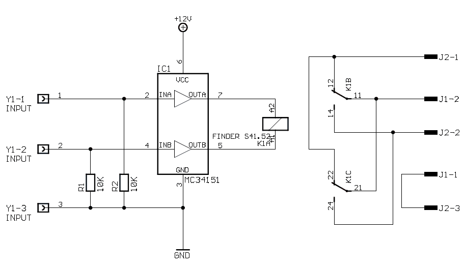

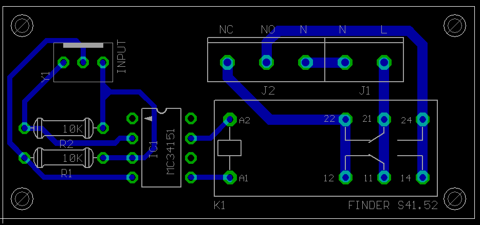

Here is what you are looking for.
Use an MC34151, a high speed dual MosFet driver (Motorola) with totem pole outputs (1.5A).
Here are schematic and PCB suggestion with a relay connected.
Boncuk

You don't have to use a relay at all. The suggestion I made is universal. Just treat the relay coil being the coil of the valve.
To have the solenoid latch logic input A should be positive (for at least 10ms) while logic input B stays low. Output A will then have VCC-level and Output B will have ground level - latching the solenoid.
To unlatch logic input B should be positive (again for at least 10ms) while logic input A stays low. Output B will have VCC-level and output A will have ground level unlatching the solenoid.
Boncuk

Hi Eric,
I've also read the bold type remark not to used bread boards for experimenting. It may refer to loads with high capacitance.
The miniature solenoid valve you're going to be using won't draw more than 100mA. The MC34151 can easily provide that current (also using a breadboard). I'd risk one fried IC to find out the proper function. :)
I guess using the SN754410 will be a lot overkill - requiring also more space.
To shorten activation pulses you might think about using non retriggerable monoflops connected to the IR-barrier delivering a pulse length of e.g. 12ms - connected to the logical inputs of the MC34151.
The two outputs follow exactly the two inputs:
InA-H -> OutA-H, InA-L -> OutA-L.
The same applies to InB and OutB.
If both inputs are H both outputs will be H as well, meaning no current flow through the solenoid - hence not a short circuit. Vice versa will be the same.
Regards
Boncuk
