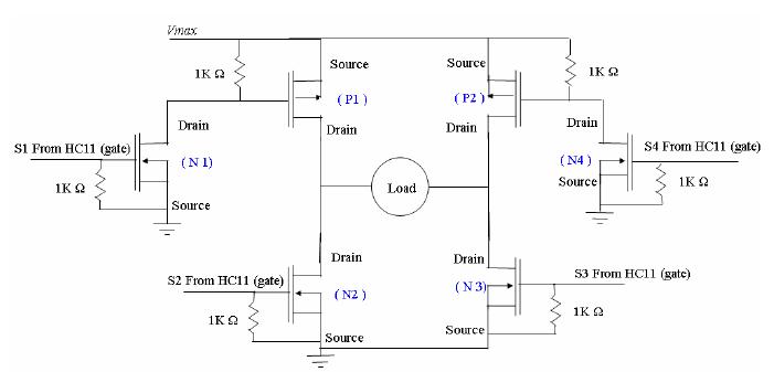

Well..this is the basic design of the circuit I intend to use. The MOSFET types are not the same though and I will add the freewheeling diodes. But I want to remove N1 and N4 and drive all MOSFETs using a MOSFET driver IC. The IC I have is the TC4427. The N-type MOSFETs are driven by outputting a '1' from the IC (which passes 12 V and up to 1.5 Amps to the gate). But as for the P-type ones, should I send a zero so that it 'pulls' the current and the gate is ON and then send a '1' to turn it off? Thanks.

Ahh a H-bridge.
Yup you can replace N1 and N4 by the driver chip to drive the P-type.
IF you were to use N-types at top you would need 24V. Why? you have 12V for you link and to turn-ON the top-FET's their GATE's would have to be raised 12V above the source. Treat the FET as a short when on puts the source at 12V, thus to ensure the gate at a higher potential it needs to be at 24V w.r.t. DC-link LOW
I dont mean to put 24V onto it, you would burn it out, if you were to take a scope probe you would see that it was at 24V.
What you have to do is use a isolated DC:DC converter and tie the 0V from that to the source of the top FET to provide a floating gate-drive potential
I go over this in the tutorial I am writing.
So as you can see it is alot of complexaty, so if you are working from 12V you might as well just use P-N type phase leg.
That driver chip will still work perfectly in this arranagement and since you are working from 12V you can reference it from 0V making control easier
Remember to turn the P-type ON you need to bring its GATE to the source potential, in this case 12V and to turn it OFF you need to bring it down low enough. Thus you can see why that chip will be fine here.
Basically because you have a complimentary-pair phase leg you send to the upper P-type the inverse signal to the lower N-type
Send "1" to UPPER and "0" to LOWER
P-type gate now at 12V at its GATE and is now conducting
N-type gate now at 0V and is now blocking

Err I kinda hate P-type N-Type phase leg I have an itching feeling you send the P-type the same signal as the N-type (no inversion) since the N-type has an inherant inversion already
One warning!!!! you are entering into shoot-through territory.

Well thanks a lot for this explanation. I really appreciate it. But I don't get something. If I send a '1' (12 V) to the gate of the P-type, then its gate will be at 12 and its source is already at 12. How will that turn it on? (Vgs = 0). And If I send it a '0', this will make Vgs = -12 V. Isn't this supposed to turn it on instead of off?! As for the shoot-through, can't I simply switch it all off, give a small delay, and then turn the other direction on? Thanks a lot.
