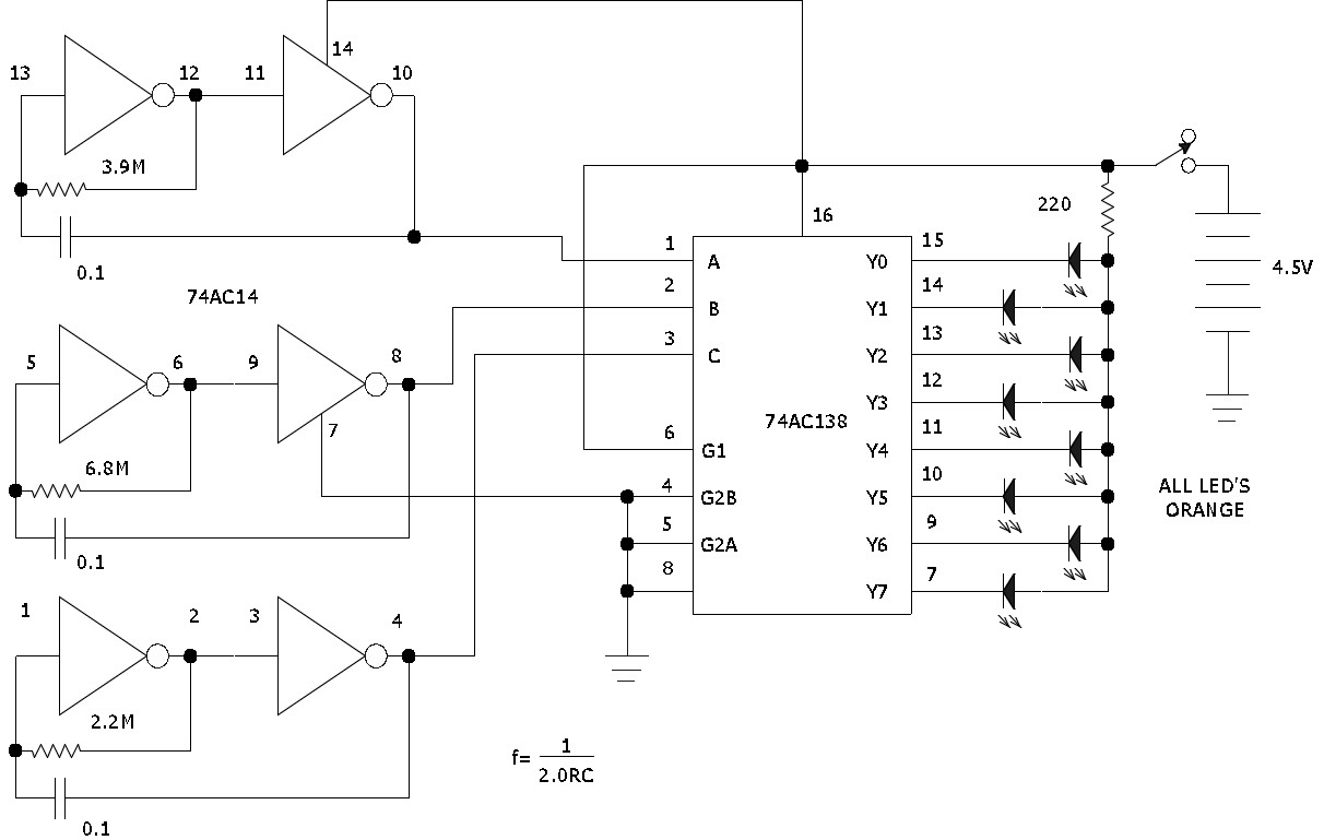

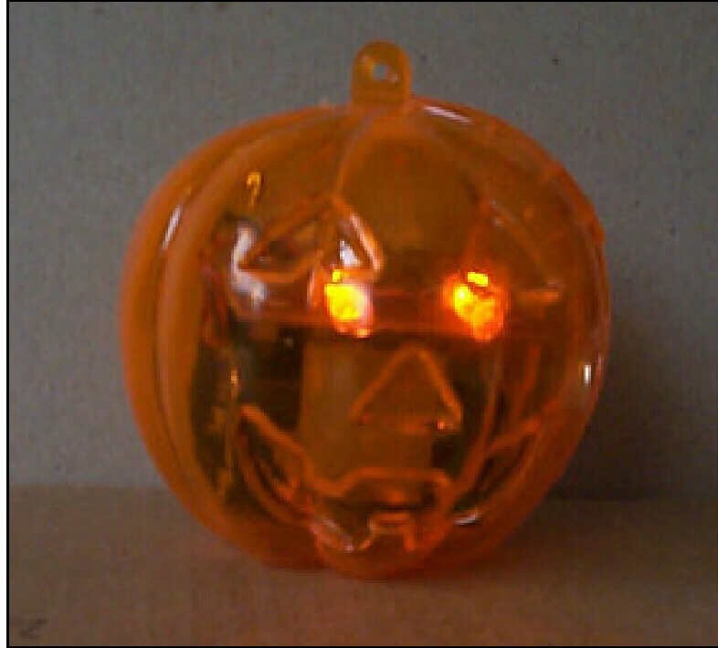

Here is a project I built several years ago. The pumpkin is about 3" in diameter. The eyes are two of the ones in the schematic.
