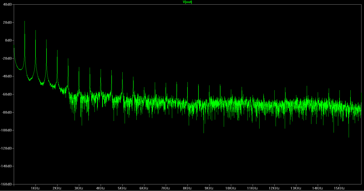

I have attached an FFT of a circuit.
How to analyse this correctly, as you will see their are odd & even harmonics.
It was mentioned that 1% (-60db) is audible, I understand that but from the picture attached what "won't you hear" or will all these harmonics be audible?
No.
1% is -40dB and is audible to almost everybody. 0.1% is -60dB. Odd harmonics sound "awful" but even harmonics are musical and don't sound too bad.

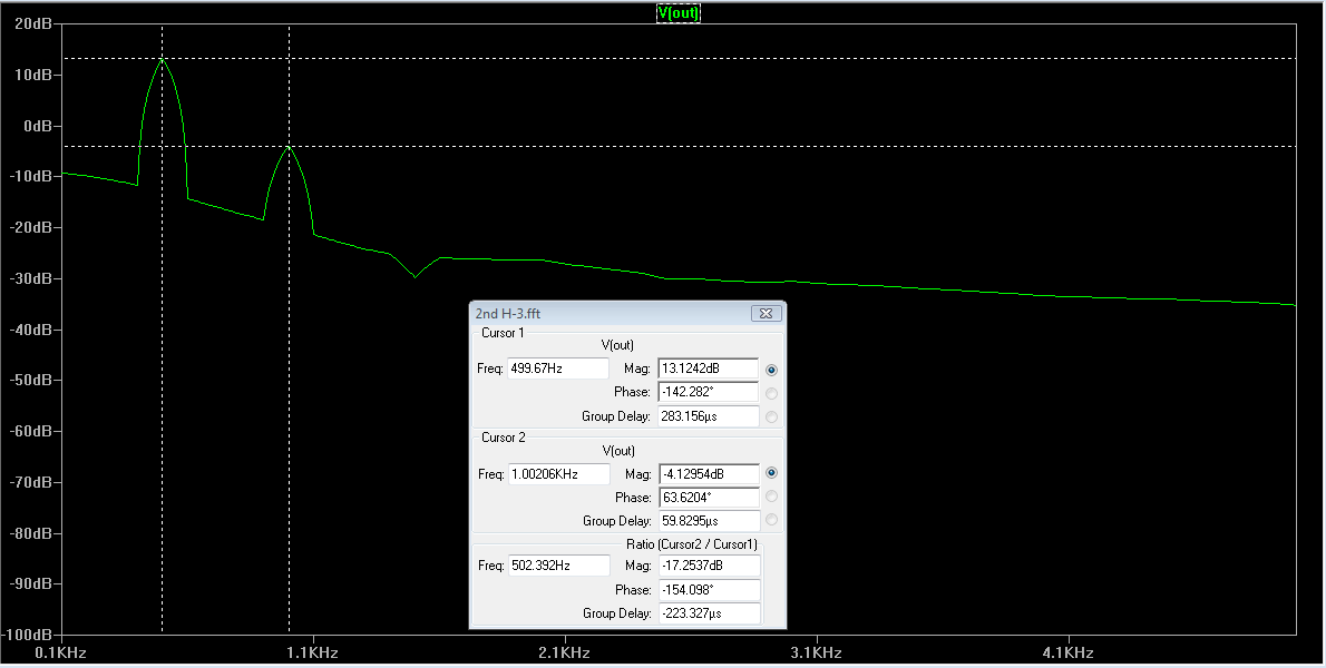

I finished designing a guitar amp circuit idea i've had, the idea was to add or take away particular harmonics as needed.
I read on Rod Elliots site where he said that basically this can't be done in real world conditions, with the FFT attached I have added just a second harmonic.
I can adjust things to get the fundamental frequency only etc.
With the components selected carefully is it possible to come close to the results that LTspice shows.
I know I have to build it to see for myself but how close is LTspice?
Cheers
I have never heard music that is a fundamental sine-wave plus only the second harmonic. Maybe it sounds something like a flute.
Most musical instruments (except a flute) produce many harmonics. An amplifier with distortion adds many harmonics. Even harmonics are the 2nd, 4th, 6th, 8th, 10th and maybe 12th harmonic and are added to all the sounds that are produced. The amplifier and speaker might not be able to produce the highest harmonics.

Yes, especially a guitar has many harmonics-overtones, I am attempting to change a few things around so I can just add in or take out what harmonics I want & be selective about it.
My reasoning is that a particular sound is made up of certain harmonics so to get those harmonics for a particular sound it should be made easier if one can add or take away what is or what is not wanted.
May be silly, but for chasing particular sounds surely being able to select the harmonics to a degree will make for some interesting tones.
The FFT posted is from my valve amp design, I can add in & or take away many harmonics with the circuit.
I find it interesting
