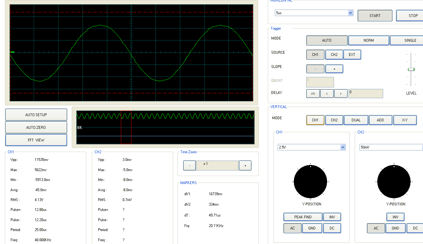

Please look at the below pic for your last question.
Actually the waveform seems to not be a pure sine wave, But I am not sure what is the problem? Maybe the signal generator itself originally does not able to produce a pure sine wave. Maybe the scope is not calibrated so good or has any problem and.... I do not know really!

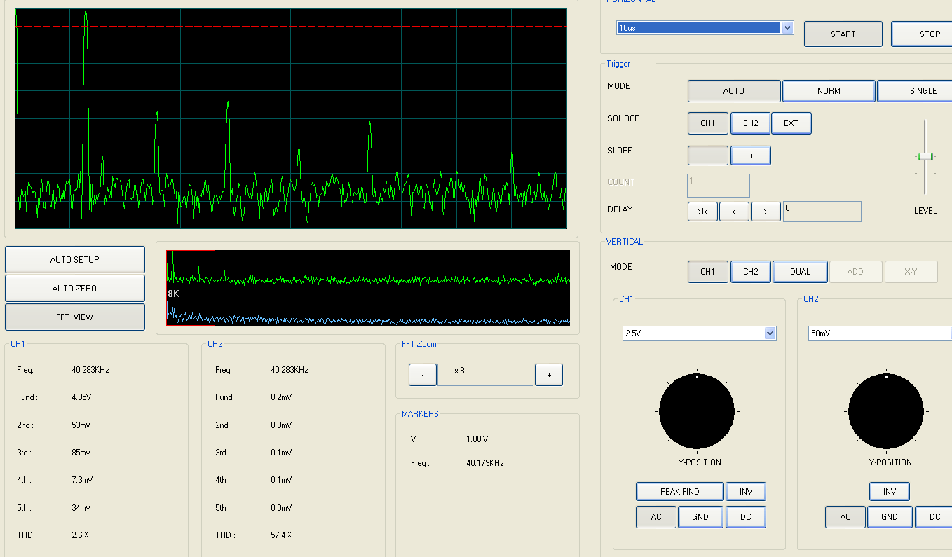

The generator has a distortion spec of 1% at some unknown output voltage. How far down are you harmonics?

The first question is how the function generator actually generates a sine wave? I did look at the data sheet and saw no mention. Many function generators use what is called Direct Digital Synthesis (DDS) to generate wave shapes. Simply put the sine is really a synthesized sine wave.
It is not at all unusual to see the harmonics you are seeing. Generally the question is how far down from the fundamental are the harmonics? This is generally specified in db and part of the specifications sheet for the function generator.
For example last week I bought one of these units. By standards it is not a high end unit at about $1,800 USD. Look at the data sheet in the link and note Wave form Characteristics and where they spell out Harmonic Distortion of Sine Wave. I bought this because right now we have a dozen projects running and I have engineers trying to kill each other over want of a simple good function generator. Peace in the valley prevails.
So is Harmonic Distortion normal? Absolutely! The question becomes how far down from the fundamental each harmonic level is.

Hi Guys,
I have got a MATRIX "MFG8216A" function generator:
https://www.yeint.fi/index.php?main...d+testing&subProductGroup=Function+generators
Today I connected it to my scope to see the waveform and FFT,
The signal was a 40kHz sine wave, the FFT showed harmonics at 80KHz, 120KHz...
Is that natural? The pure sine waves do not have any harmonic. so..?

As others have pointed out already, the 'function generator' may not put out a very perfect sine wave and/or the load may not be correct for that kind of generator.
One simple test you can do is to build up a little bandpass filter to pass the fundamental (like 20kHz) and see how much that bites into the other harmonics. You can then do either a simulation or a calculation to determine if it brought down the harmonics (and possibly some of the fundamental) as the filter should have done, and that will tell you if the harmonics are coming from the generator or not. If that's the case (and most likely it is) you can use a filter like that to get a much more pure sine wave if that is what you are after.

The question is: what is the amplitude of the harmonic frequencies as compared to the fundamental frequency (how many dB down from the fundamental)? That will allow you to approximate the percent distortion.
Edit: If it hasn't already been noted, 1% distortion is not generally visible on an oscilloscope trace of a sinewave.
1% is about the limit of visibility, but you'd be hard pushed to tell - however, it will show clearly on his FFT trace, which is what he's looking at.
Basically he's worrying about nothing.

Basically function generators aren't intended to be low distortion, or used for audio testing - it's a crude general purpose waveform generator.
Usually they generate square and triangle waveforms, with the triangle then been crudely shaped to approximate a sinewave.
For an audio generator, you would generate a sinewave (wien bridge etc.) for a very low distortion (0.01% wouldn't be uncommon), and then overdrive and clip that to generate a squarewave.
