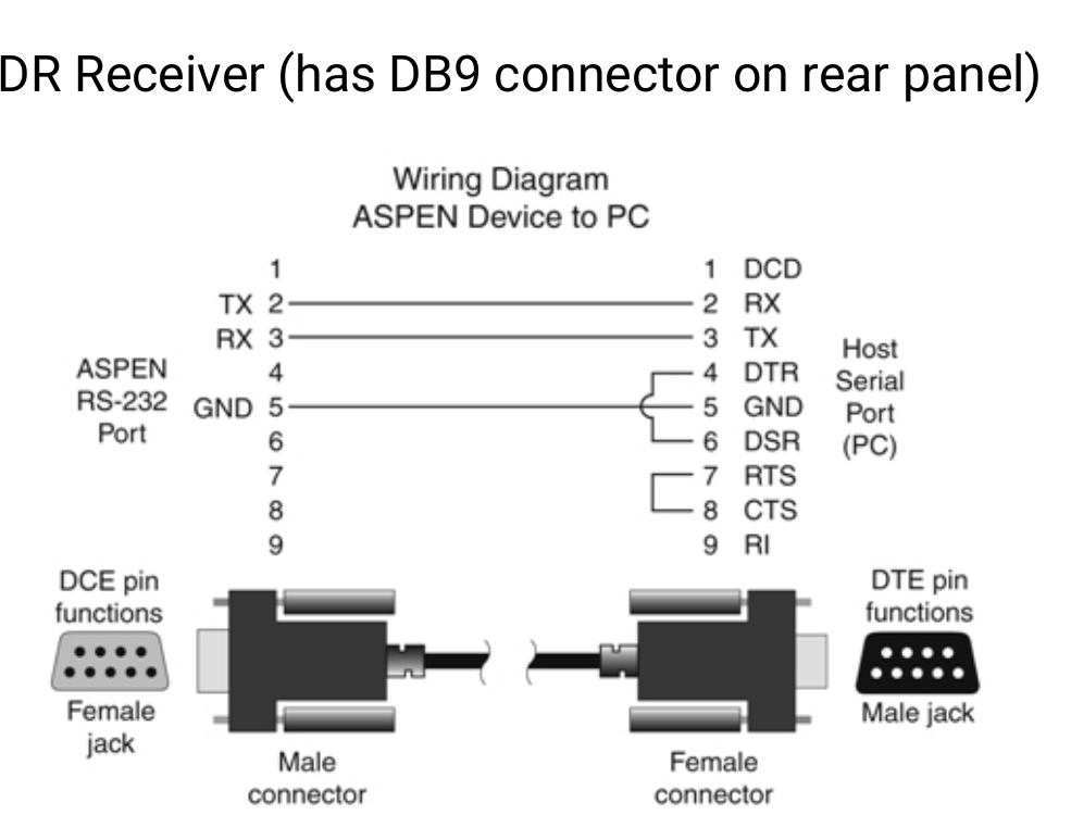

How can wires be connected at one end and not the other? Edit, unless they have a break.
Wire harness? The tester could be complicated.
iu
It's not uncommon, as I stated above. The diagram of a serial cable shows pins 4 & 6 and 7 & 8 connected together on one end of the cable with no connection on the other end. Note - this is the FIRST picture that came up when I searched for RS232 cable connections.
