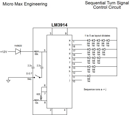

I started out like everybody else, except it was '76 and there was nothing like this forum... Using a LM3914 is straightforward, as it's a constant current driver and sequencer in one. As such, you can mix the number and types in a string.
I attached one version of a turn signal I've done. One thing: add up the voltage drops of any LED string you'll use, there's a minimum voltage margin for the 3914 to work with. (6 LEDs @ 2Vf each = 12V: won't work well, if at all) Good Hunting... <<<)))

Build it & play, reverse polarity is the only thing I know that'll quickly kill a 3914. The DOT switch is for instant on (no cap charging into V in). For slower sequences, a diode (not shown) from the V in cap and reversed to the power feed will drain it during the flashers' power off time. <<<)))
