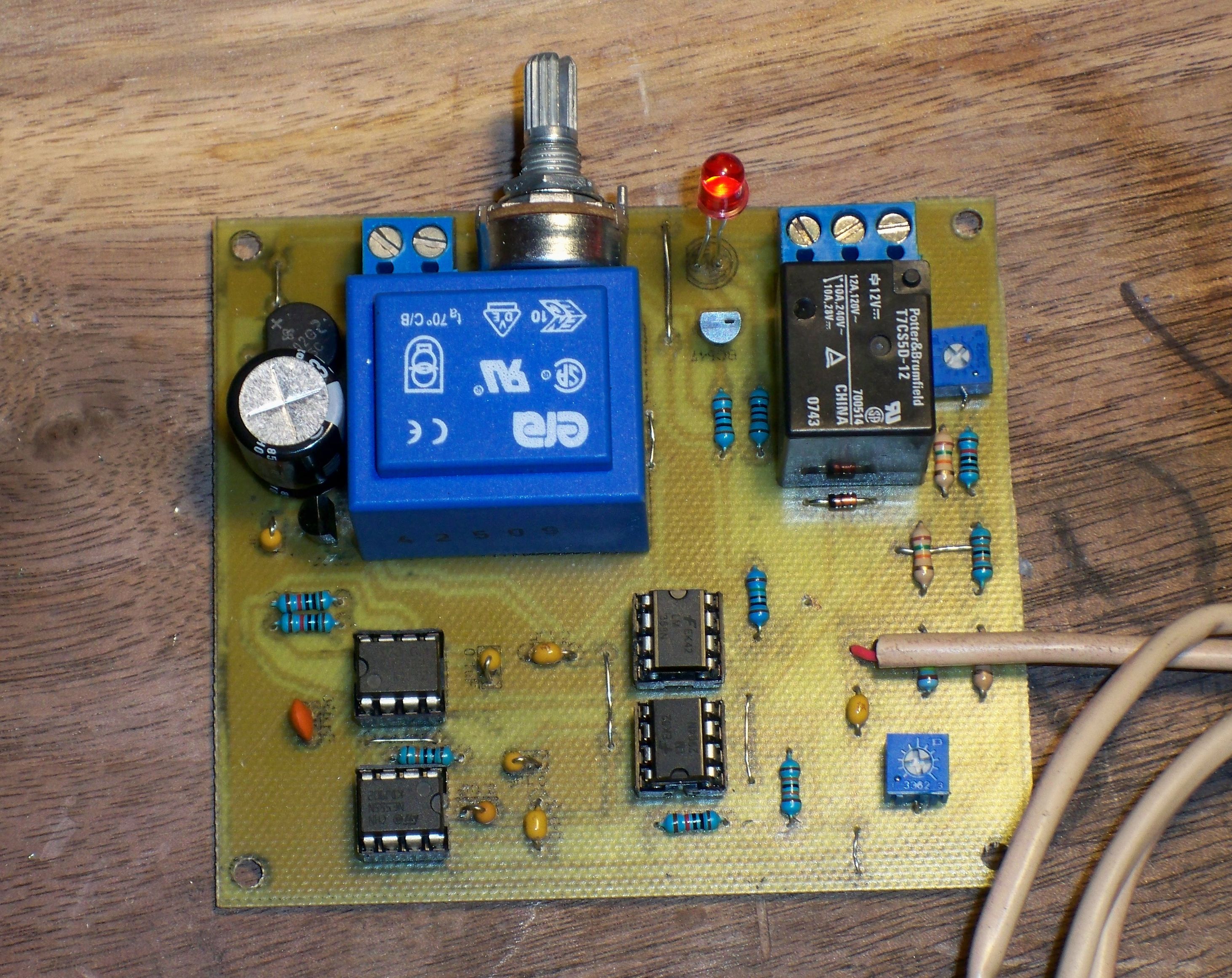

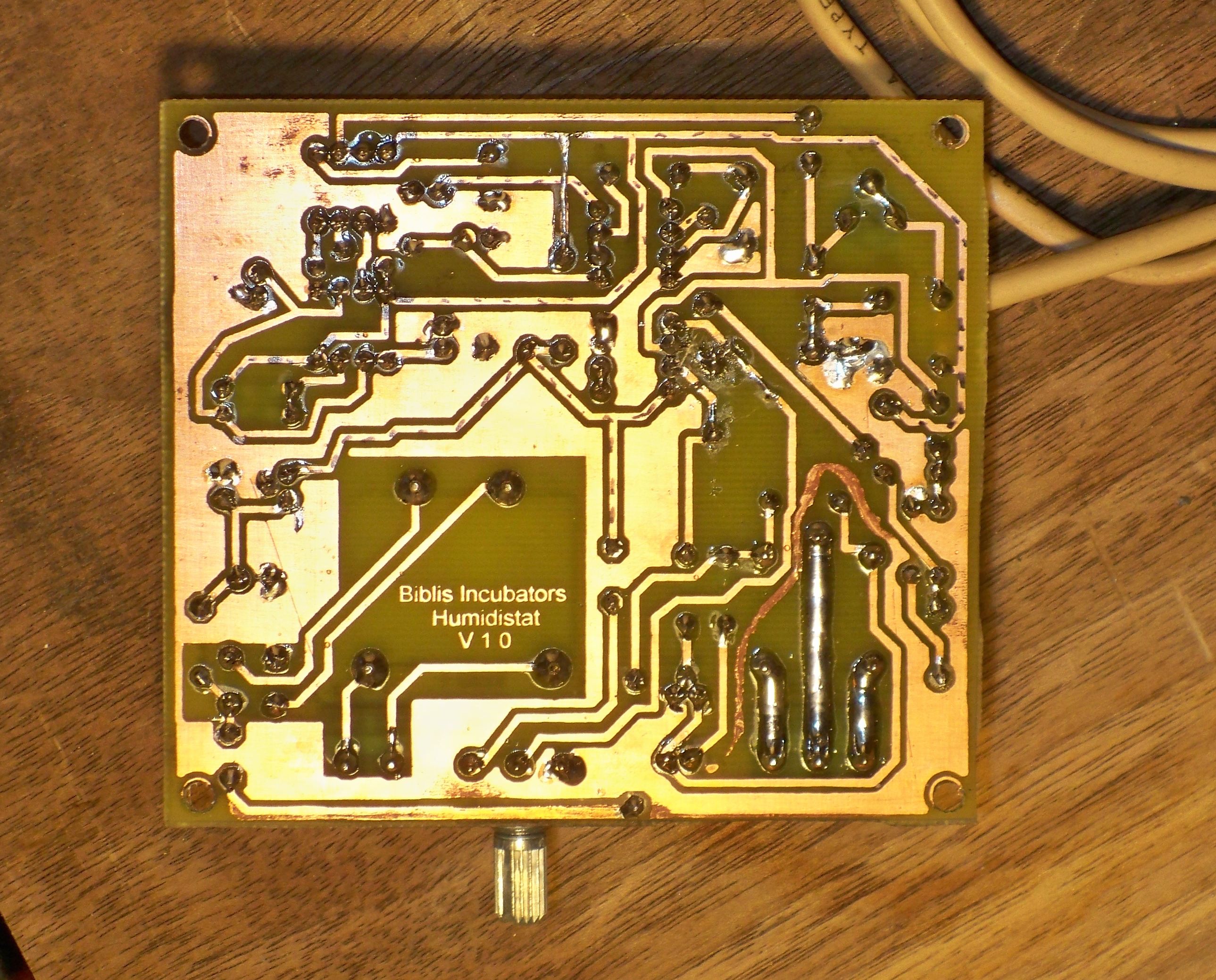

Here you go. I was able to cram it on a 3"x3.5" single sided PCB. i had a total of 9 top layer jumpers. i could have made it a little smaller however i wanted to flood the board with ground to isolate the ac from the dc.
i haven't had a chance to test out the circuit yet. However i did make the mods. I will keep you posted.
Sorry about the pictures earlier here are some better pic's.
As for my defense in the PCB design, I through this together in a short amount of time ( 8 Hours from final post confirmation ). This is only a prototype to test the circuit in real time. I am aware of the 90 degree bends and the last minute magic marker isolation nears the relay traces. I will remedy these and other errors made in haste.
