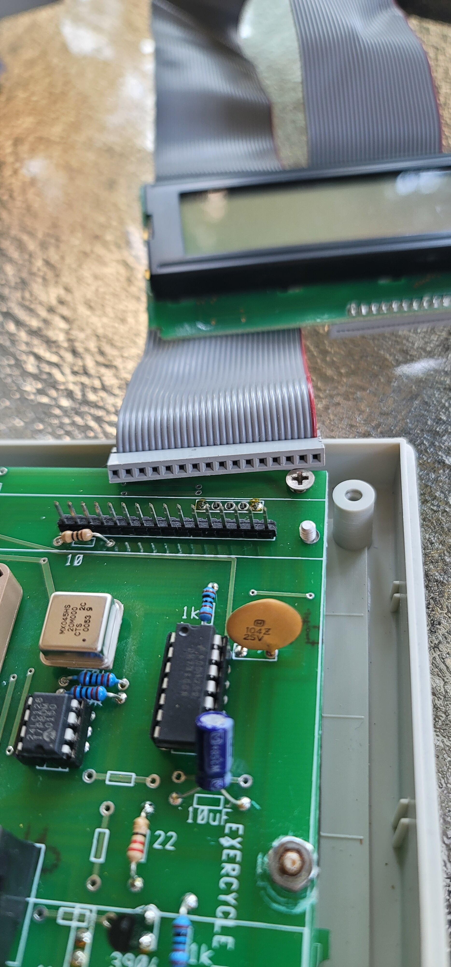

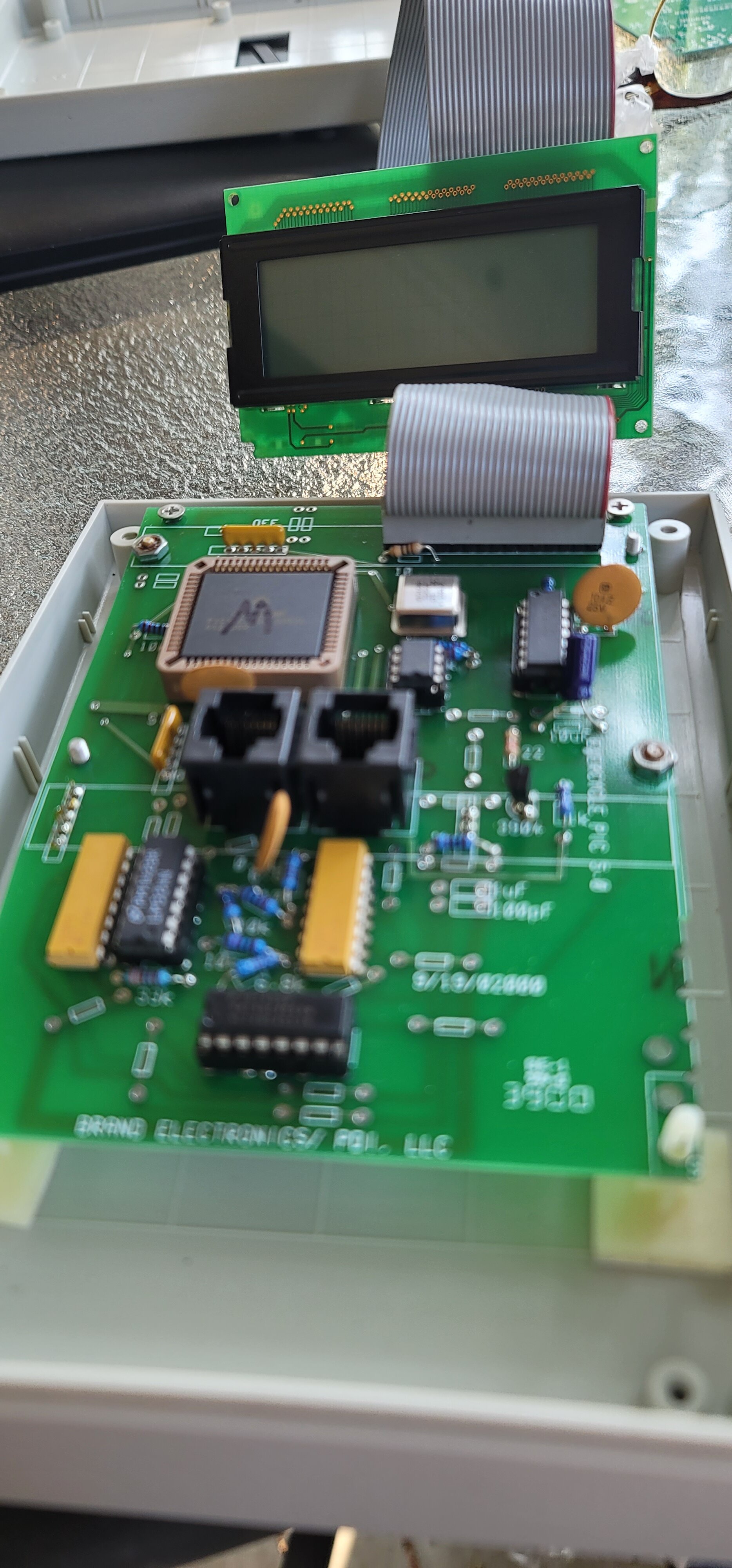

Let's start with a few pictures to clarify things.
Here's my test setup. New display paralleled with old, pin for pin.

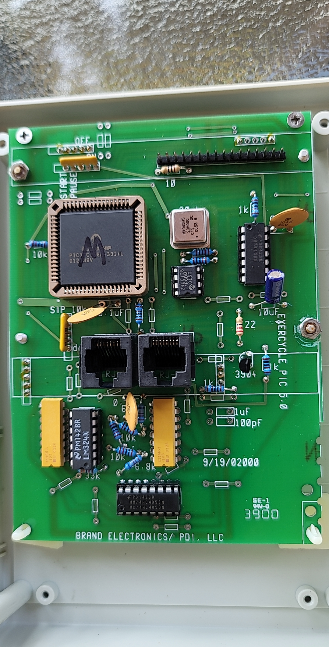

The top view of the board.

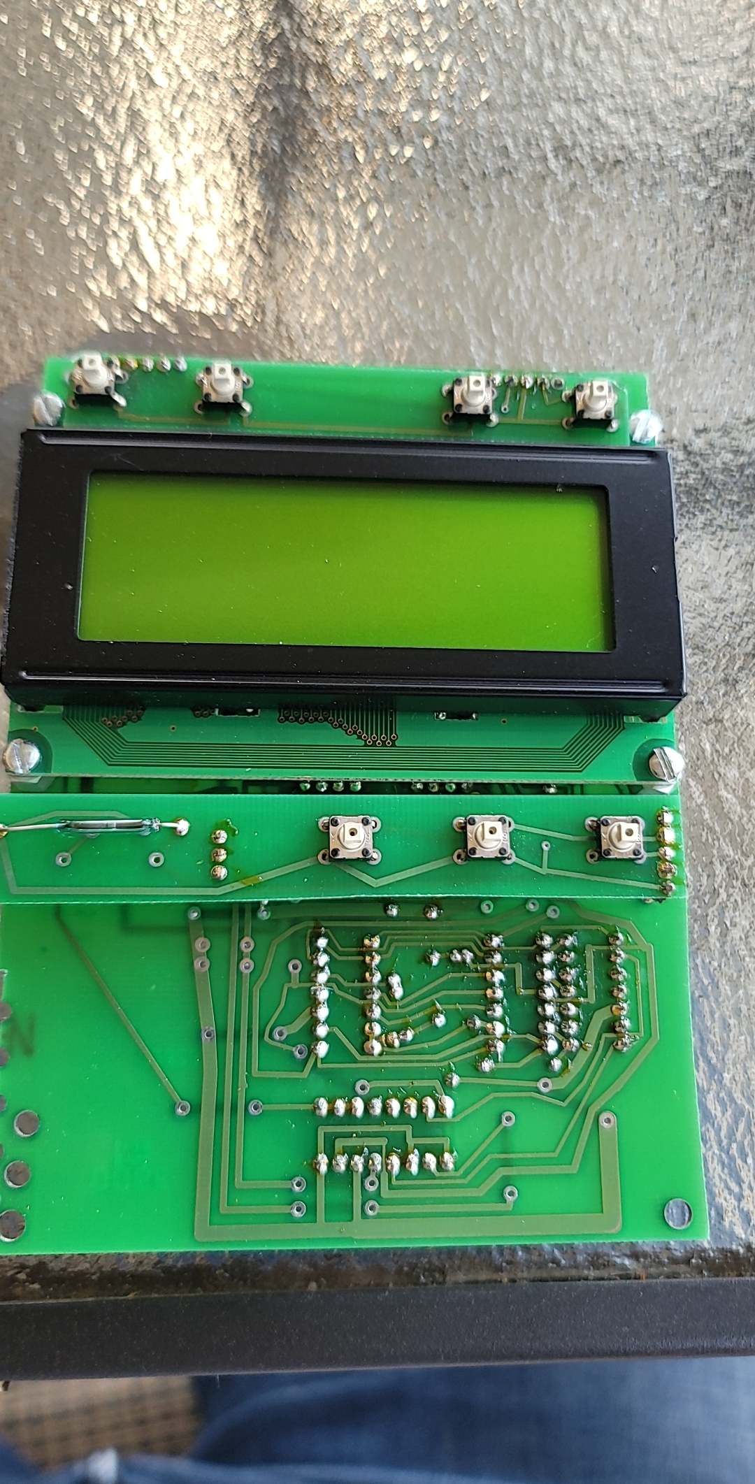

The bottom view of the board.

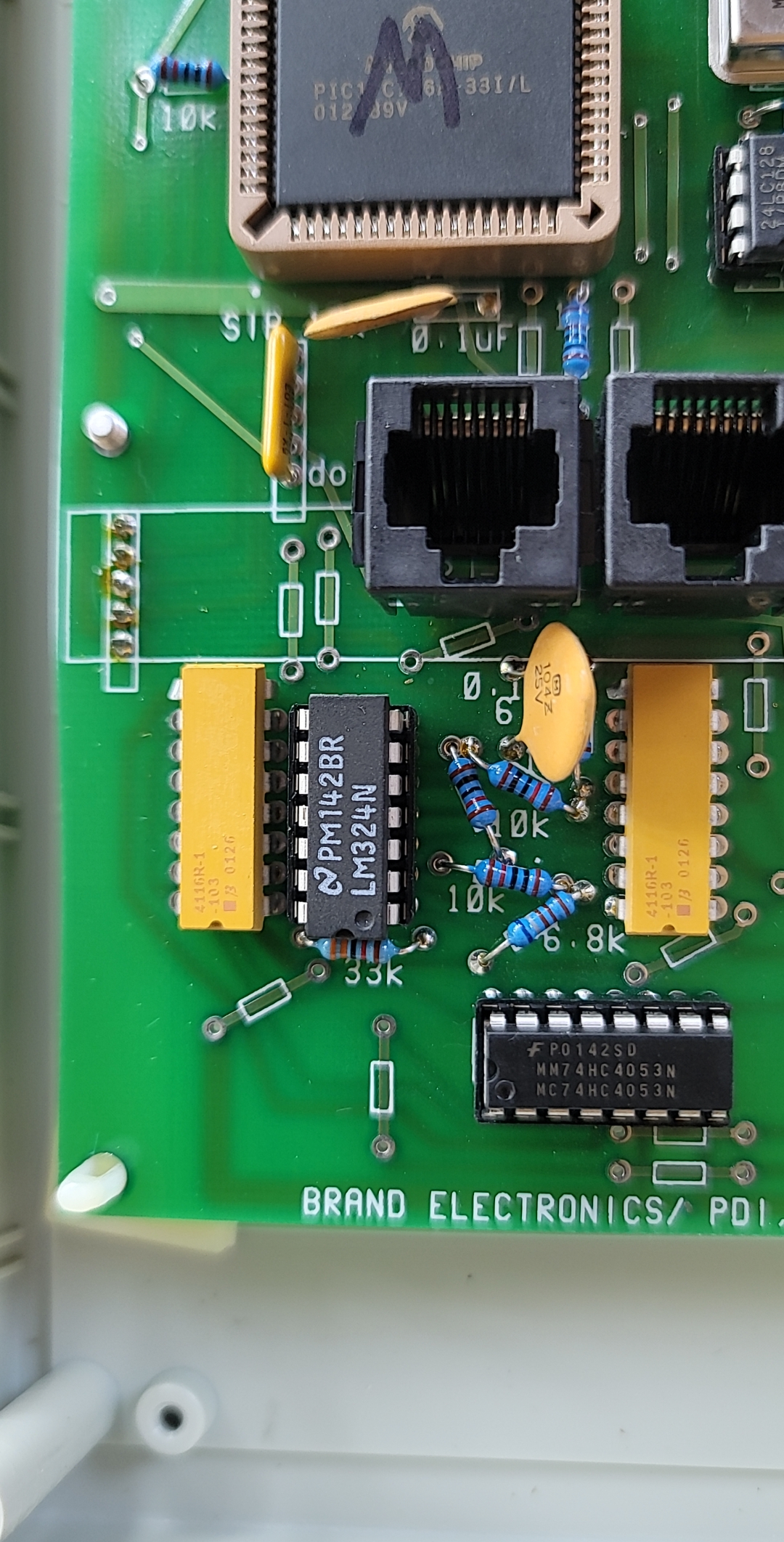

The following chips are on the board.
PIC17C756A-33/L MCU 8-bit PIC17 PIC RISC 32KB EPROM 5V 68-Pin PLCC
MM74HC4053N Triple 2-channel analog multiplexer/demultiplexer
LM324 QUAD OPAMP
2N3904 NPN TRANSISTOR
24LC128 EEPROM
DM74S00N QUAD 2-INPUT NAND GATE
Trying to trace the tracks on the board is nearly impossible with the LCD soldered in place and the crazy track routing. Fortunately, there's not much to trace as far as my issues are concerned.
You find PIC's in almost everything, they are a very popular processor - this is obviously an old unit, as it uses an OTP device.
LM324 QUAD OPAMP
24LC128 EEPROM
