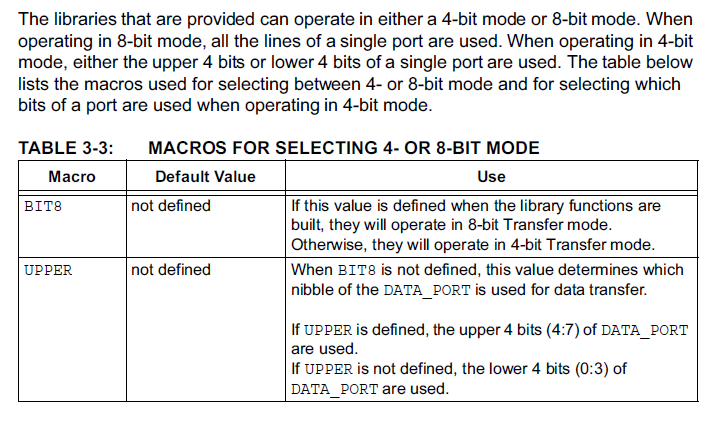

Those LCD modules can be used in 4bit mode so only the 4 upper data lines from the LCD are required.
that makes more sense then. so should I just hook up 11-14 to port B 0-3?
Yes, that would work. You also have to change the code as mentioned in the library pdf:
Thnaks,
ive changed the call in openlcd to FOUR_BIT, and left UPPER undefined. I'm not sure what else is needed.
