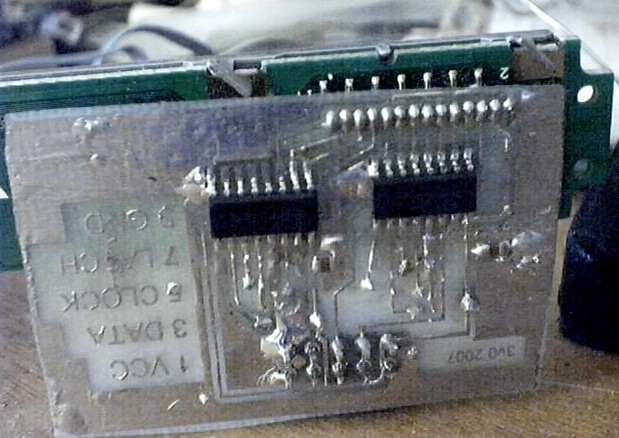

If I remember correctly, they showed driving the SCLK pin with an RC delay to the RCLK pin (a 100 ohm resister between the two pins and a 200nf cap' on the RCLK pin). This allows data to stay in sync' instead of being 1 bit behind as would be the case if you tied SCLK anr RCLK directly together.
Unfortunately this wouldn't be a 2 pin interface because you would still need to drive the LCD 'E' line. I apologize.

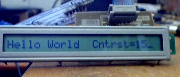

A while back I had fun with this inexpensive LCD. It is $2 or less from Electronic Goldmine G15318 and AllElectronics LCD111.
Wintek # WDC2401P-1GNNA. Module size: 4.25" x 0.79" x 0.3". Display size: 3.5" x 0.4". Built-in driver. 14 pin male header pins on 0.05" centers. Includes hook-up diagram
It has internal logic to control the contrast. The display is hardwired to use the 8 bit interface. It has a built in I2C interface but you have to do a mod to use it. The problem is that the wire you need to cut may or may not be hidden under a epoxy blob on the unit. On the ones I purchased epoxy covered the traces in question. Also the pins are on .05 centers. It does not use the HD44780. Yup, it is cheap for a reason.
A while back I built a 3 wire interface using 2 SOIC 74HC595s. This is my first SMD board.
That looks incredibly nice and after looking at the data sheet I realize you did some pretty good detective work and design work too (grin).
Mike
