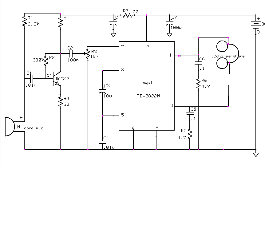

still contemplating building a hearing aid for when I go to the gym or other environments that I will sweat a-lot. Sweat plays havock on hearing aid electronics. The mics and all other electronics to be mounted on the chest using a necklace harness or ?. Have a switch for front and back mics or front only.

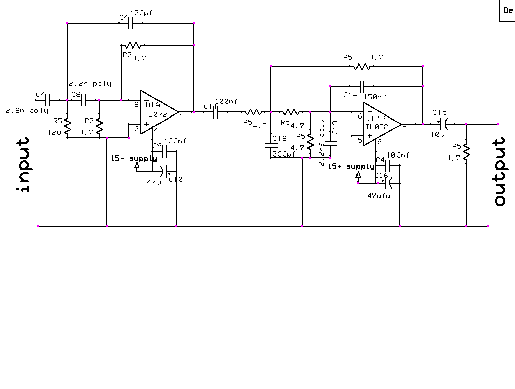

Found this little circuit using a TDA2822M stero amp (used a-lot in walkmans etc)
then found a speech filter circuit using a TL072.
Plan is to use two 8 ohm earphones instead of the 32 ohm headphones. Use some SMD mics
SMD Microphone (Pkg of 2)-The Electronic Goldmine
then the earphones
Replacement Earphone-The Electronic Goldmine
thinking that since the amp is stereo and found a circuit using the RDA2822 with two speakers (reconfigure the hearing aid circuit for stereo?)
BUT the TL072 shows 15v duel supply where the amp is 3v single supply. how to combine or will the TL072 run at lower voltage. Couldn't make heads or tails of data sheet Vcc
any suggestions. plan to run sim in TINA to see just how well the filter works.

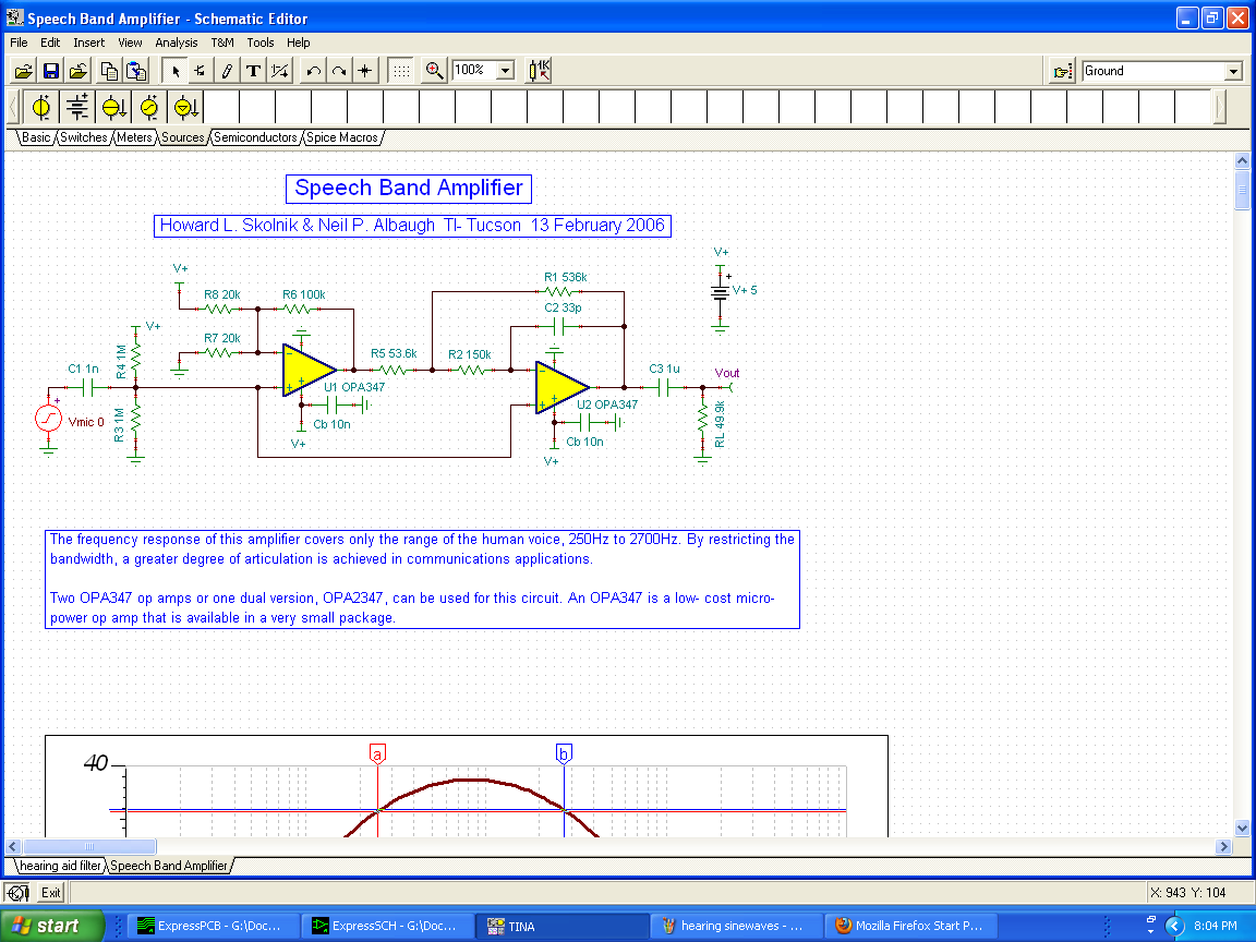

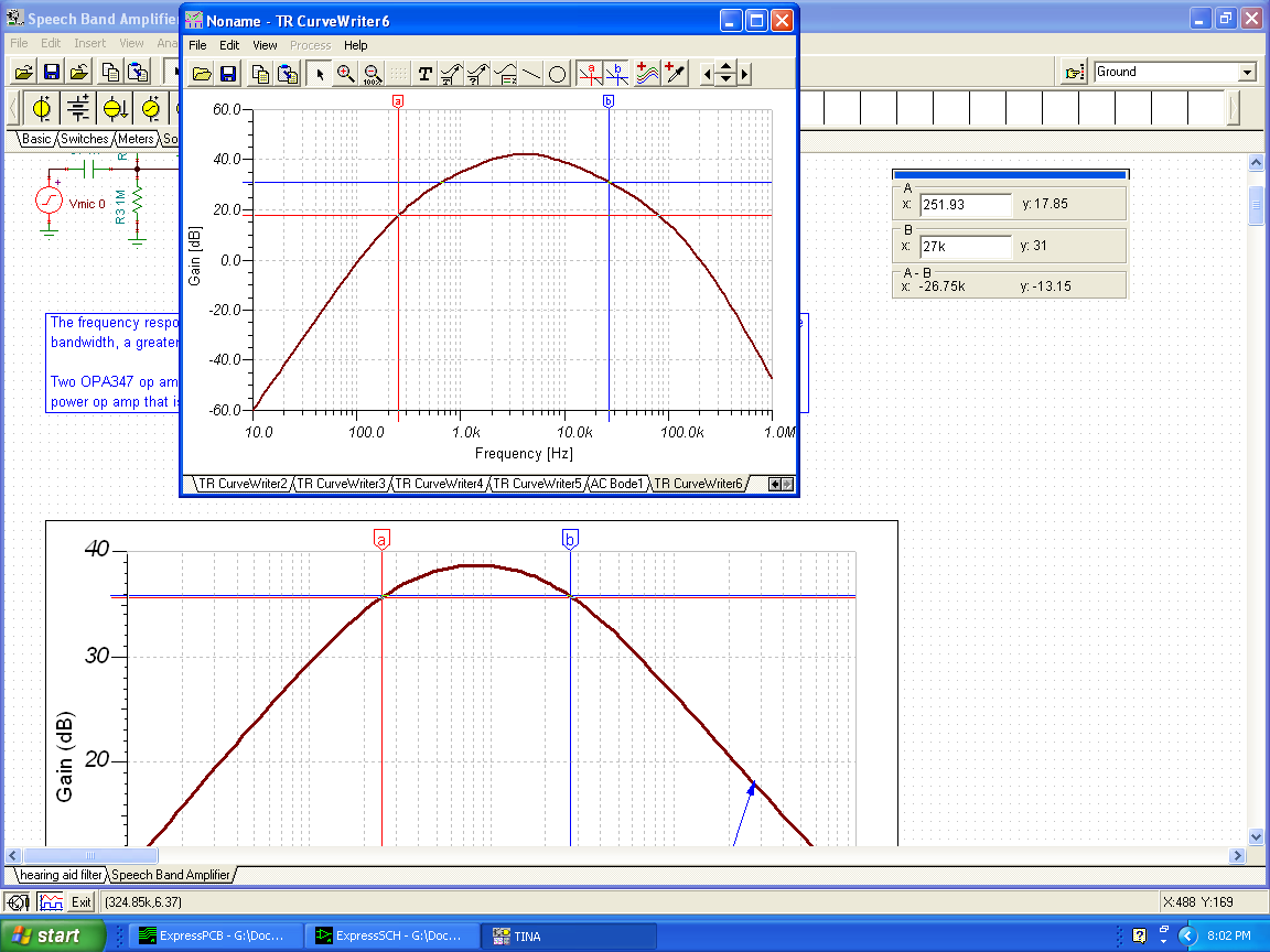

hearing aid filter simulation
not sure of what I am looking at but the schematic I first posted has more db gain but is this desired?
the attached screen shot shows both waves forms of both circuits
the wave form in the smaller box is my first post. the larger box shows the wave form of the circuit in this post. about 35db but a narrower wave?not as wide as the smaller box.
the second circuit shows a 5v single supply
which circuit in your opnion is better for a hearing aid filter?

The minimum total supply for a TL072 is 7V. It works well from one 9V battery but your filter circuit is designed for a dual polarity supply.
Why use a "speech filter" that cuts all important high frequency speech consonants that reach up to 14kHz and higher? It cuts all the natural sounding low frequencies too. Don't most hearing-impaired people need equalization (boosted high frequencies, not cut high frequencies)?

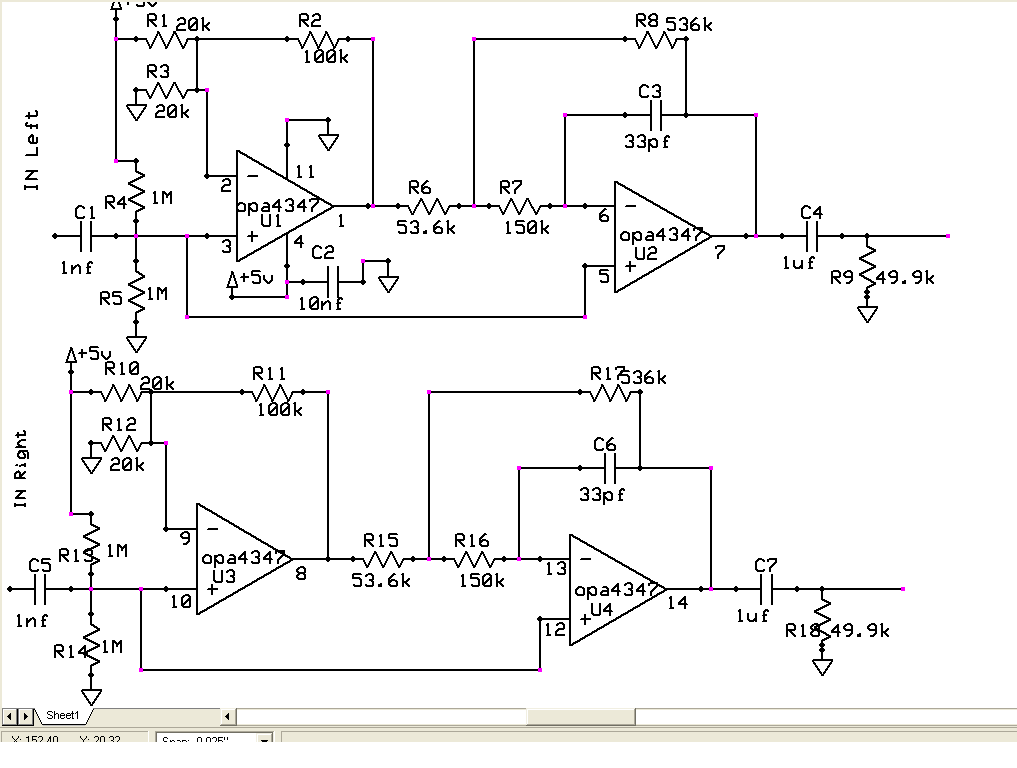

revised speech filter using OPA4347
the revised speech filter uses a OPA4347 (4 op amps in one pkg)
Single supply, 2.3-5.5v Vcc
thinking of getting one circuit built then add filters for different frequencies maybe.

R7 connects directly to the battery with no filtering so the amplifier will probably motorboat as the battery voltage jumps up and down with the signal then is amplified.
Opamps 2 and 3 will not work because they have no input bias voltage. They will be a rectifier.
The opamps you selected are in tiny surface mount packages only.
The TDA2822 has 16 through-hole pins. The TDA2822M has only 8 through-hole pins.
need_want small package
reason for SMD
R7 is supposed to be connected to a clean 3.3v supply while the op amps opa4364 power is 5v
the tda2822m? is an 8 pin smd

Can you solder to SMD? I never tried it.
Yes, but you did not show how you will make a clean 3.3V supply. You showed a 3.3V battery.
Where will you find a 5V battery? I would power everything from a small rechargeable 3.2V to 4.2V Li-Po battery made for micro RC model airplanes.
No, it is in an 8-pins DIP through-hole package. A TDA2822D is in an 8-pins surface-mount package.

Your highpass filter cuts frequencies below 300Hz so everything will sound "tinny" like a telephone. You do not need a lowpass filter to cut ultra-sonics above 14kHz.
Your software is selecting impossible resistor and capacitor values.
NOTE the opa4364 is a single supply op amp BUT the data sheet mentions a buffered reference voltage if this is any help?
ANY opamp works perfectly from a single supply when it is biased properly. Your opamps B and C are not biased properly.
Your circuit does not need a buffered reference voltage. Two resistors making a voltage divider and a filter capacitor to ground will bias opamp B properly. Opamp C is biased from the output of opamp B.
