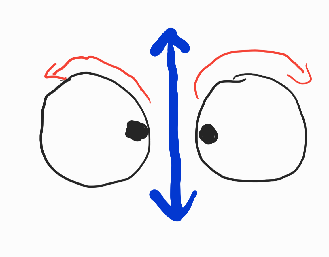

If you want to cancel only the 1x force in the vertical direction, you should use a pair of synchonized counter rotating eccentric disks. They will only generate a vertical force The sideways forces from each disk cancel because they are in opposite directions.

Note that with the shaker I have described and also with a motor with a mass imbalance, the resulting force is a fuction of speed, so either method would only work over a narrow range of rotor speeds. For the shaker I described, the force can be adjusted by moving the weights in or out; in the shaker I have used, this is accomplished by bolting the imbalance weights at the necessary radius.
