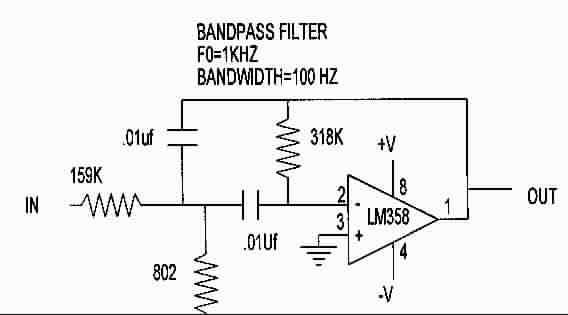

Hello, please can some1 help me with my A level course work. im tring to design a light to sound display picking up the out put signal from a CD player. ive decided that i am going to have 3 active bandpass filters picking up diffent frequencies and lighting specific lights but i am stuck on how to do it. can anyone help?

Here is a bandpass filter, 1kHz center frequency, 10% bandwidth. To change the frequency, same % bandwidth, just change the resistors in the same ratio as the frequency. (The bottom of the 802 resistor got clipped, it goes to ground)
