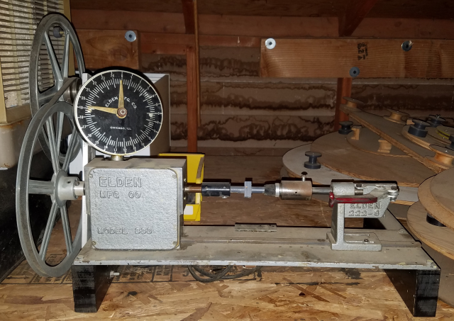

I used a mechanical turns-counting dial from reddington for a work project long ago.

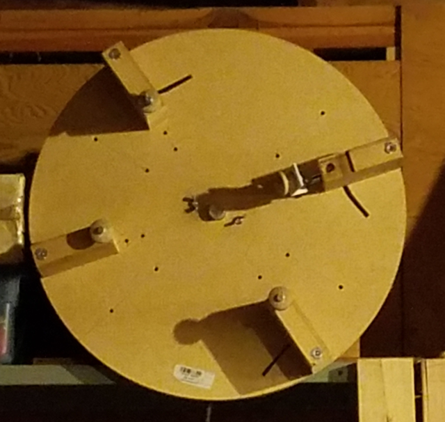

My first coil winder. Has 1/4 horse power and foot pedal speed control. You can't see the size but I have made 1000 watt transformers. About 40 years ago we added a speed reduction so I could pull heavy wire.

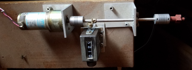

This is a small version I made. I need to have much less power. It runs from a bench supply. By setting the current limit small it will stall out the motor before it breaks the wire.

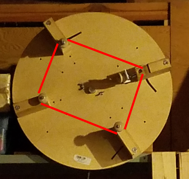

You can not see the 1/4 horse gear motor behind + counter with stop switch etc. It was built to wind degaussing coils for TVs. It also makes metal detector coils.
It makes coils as small as 4 inches to as large as many feet. I have many jigs. The one shown is about 2.5 feet across. I added red lines to show the shape of the coil.
