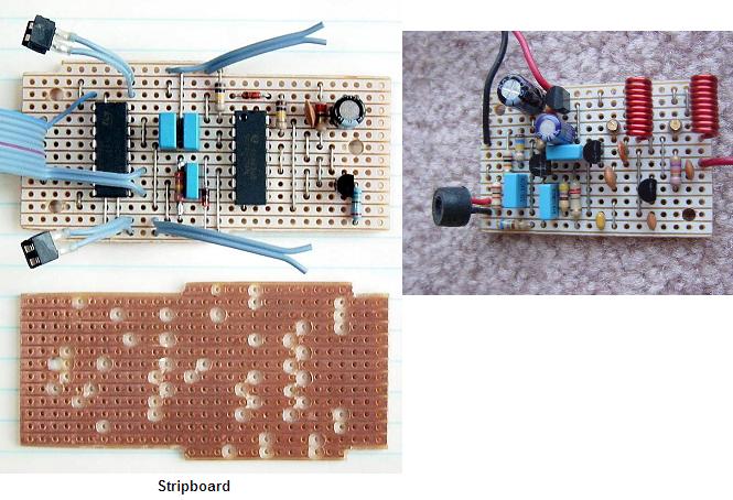

Here is the copper horizontal strips on the back of stripboard. I show two circuits with the strips cut and the jumper wires and parts connecting the strips into circuits.
Looks very neat. Could I have a look at one finished soldering?
What did you use to drill the copper off, it doesn't look like a regular twist drill bit. Where do you get stripboard?

Stripboard was first made by the Vero company and it is called Veroboard.
I always used epoxy-fiberglass Veroboard from England until Vero sold the Veroboard division to a group of its workers then it was not available anymore in Canada. I used the terrible poor quality Radio-Shack one for a few years.
I was lucky that a local Chinese electronic parts store sold an excellent Chinese copy that I used for about 15 years until it was not available anymore. Then I found an Arab electronic parts store that sells a Taiwan copy that stinks (made from dung?) and warps but I still use it.
You cut the tracks with the tool at the top of this photo,
Or, you use a twist drill.
